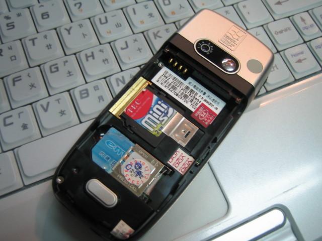

Guest saintone1 Posted November 18, 2005 Report Share Posted November 18, 2005 (edited) I am currently using a 2GB mini SD card from TECIC that I bought in Taiwan. Cost me NT$5000 which is about US$150 / EUR130 / UK86 It works perfecting in my Dopod 577W (SP5). more info about this card can be found here (site is in Chinese, sorry): http://www.mml.com.tw/topicdetail.php?f=243&t=59595#376037 Note: The pictures below are not of my phone. Edited November 18, 2005 by saintone1 Link to comment Share on other sites More sharing options...
