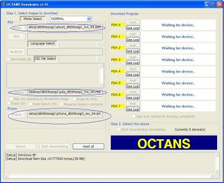

A)Flash ROM Softwares
XP OS Computer SP3
ActiveSync 4.5
Samsung CDMA_Modem_4.34
OCTANS Downloader 1.9 /2.0 new version
B)Procedure
In this OCTANS Downloader, Please select and put
1) E.boot
-> Eboot_I8000XXIG1_HW_40.eb0
2) MoviNAND -> PDA_I8000XXIG1_HW_40.MST
3) MultiCSC-> I8000XSOIG1.CSC
4) Phone ->
Phone_I8000XXIG3_REV_04

This is where im up to, how do i flash from here?
Ive connected my phone via activesync...
Also does flashing remove your files from your main 8gb storage?
