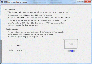

Now, Inside the folder that you chose, there is an exe file called download_nochecksGen2.exe. Just run that file as Administrator. You will be presented with the following screenNow, on your phone, power it down, remove battery as it's not needed to flash. Now holding down the volume-down key, connect the usb cable.
You will be presented with a screen that says FTM.
Now connect the phone to your PC, and then the Start button becomes clickable after a few seconds, assuming all drivers have been correctly installed.
Just hit Start
It will take 3 minutes or so to completely flash. DO NOT interrupt this process in any way. When this completes 98%, Clockworkmod recovery will start automatically on the phone. Wait for the process to complete.
After flashing is complete, you will get a prompt on you computer screen saying flashing is done.

1. Save restore_stock_recovery.zip, recovery-clockwork-3.0.2.8-blade-gen1-update_signed.zip, and Swedish_Spring_RLS5.zip to your phone's SD Card.
2. Restart your phone with volume down held. From clockworkmod recovery, flash restore_stock_recovery.zip. This will replace clockworkmod for the time being.
3. Restart your phone with volume down held. The words FTM should appear on the screen.
4. Connect your phone to your PC via USB.
5. Unzip the contents of Gen2toGen1Windows_v2.zip to your computer and run download_nochecksGen2.exe. There should be a green “Ready” under the start button. Press the start button.
6. Wait patiently while your phone is upgraded. Do not interrupt this process! Your screen will go black for a while.
7. When the upgrade is complete, a message will appear saying that flashing was successful.
8. Disconnect your phone and remove the battery. Reinsert the battery and turn on the phone (normally, with no buttons pressed). Your phone should boot into clockworkmod recovery.

does not sound bricked if shows FTM, the stock rom removes clockwork and replaces it with FTM, so now you run the upgrade
Hum nothing happens - the download.exe software says that the port equals 'null'?
so you have started download.exe, taken battery out of blade, hold volume - button, connect usb cable, and the zte diagnostics mode driver does not install?
Nope - never happened - however I see there is a driver in that folder - shall I install it manually?
Edit: OK, I installed it manually - now when I hit start, I get the error message - "line1: can't open partition.mbn'.
I notice when I start download.exe that it does tell me that sysdy/files 'is not exist'?
Is that the problem that for some reason the program is not picking up this files folder (even though it's is there in the Sysdy folder.
