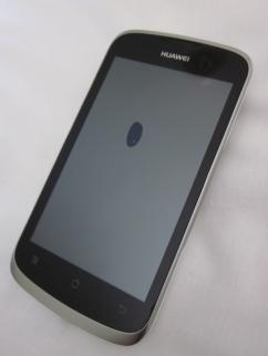

Having owned it for just over a week, my G300 has just developed a 'blob' in the middle of the screen. It reminds me of the kind of air bubble you sometimes get in poorly-applied screen protectors. I can't tell whether there is one applied or not and I don't want to scratch around the edges too much in case there isn't one and ragged edges voids my warranty.
Can anybody confirm whether the G300 has a screen protector on by the manufacturer? I know my San Francisco had one on out of the box.

No it doesn't have one. It could be your digitiser is coming away though as its not very securely connected to the screen.
It has gorilla glass so a protector isn't seen as being needed

Update. Have played about a bit after noticing that it was changing size regularly. It happened most when I pressed the back of the phone. Took battery out and pressed about a bit more and now it has gone. Something must be putting pressure on the screen from behind. It's clear for now but I'm worried it will return.

That really isn't good. If it comes back please take another photo before you return the phone. If anyone else has issues like this, even if they are small, please take photos and share on this topic.

I noticed a small white spec where the "hole" appeared. Can you take a close up of the place where the "hole" used to be?

There is absolutely no evidence of where the hole used to be. I can try taking a close up shot, but I don't think it will reveal anything. I am pleased to say that I have been carrying it around in my pocket as normal for the past week and the problem has not recurred. From the way the blog changed shape and size when I was pressing from the back with the cover off, it seemed to me that something was pressing into the screen from that side. I will take better pictures if it happens again.

The blob returned again yesterday. I was not at home, so was unable to take pictures. Again, it was when I had been carrying it around in my jeans pocket. Blob was in the same place and similar size. After spotting it, I left the phone on the dashboard of my car (on a grab mat) while I drove to work and by the time I got there it had gone again. There was no need for me to poke around to sort it out this time; it just went of its own accord. I am assuming the vibrations from the car shifted whatever is causing it this time.

The silicone cases do give these cheaper phones a more solid feel (they certainly improved the feel of my San Francisco) but the blob was back again yesterday despite the case and screen protector I have been using for the past few days. Once again I was able to get rid of it after a while by removing the back cover, battery and SIM card and pressing about a bit from that side; particularly in the area of the SIM card slot. The blob changed size and shape as I did so and, after a bit of persistence, disappeared completely. When it disappears, it looks as though it is being 'sucked' into a tiny hole, which seals up without trace. In other words, the blob shrinks rapidly and disappears, as opposed to the whole shape vanishing instantly.
I'll try to capture it on video if it happens when I am at home. Typically, though, the only time the phone is in my pocket is when I am out and about, so have no access to cameras.

I had the same thing happen on my phone last week. The blob appeared in the same position as in the image you posted, the phone had been in my pocket as well. When I tried pressing on the blob it got bigger and stretched out to the edges of the screen, like when you try to flatten out a screen protector.
Fiddled around with it for a while and it eventually went away.

Same here, had the blob after having the phone in my pocket. Thought it was condensation or something. It has never been back since but still, not a good sign so many folks having the same problem.

As I was applying a screen protector I had 2 blobs appear. They looked like air bubbles under the screen protector at first. They changed in size when I pressed them.
In the end I rubbed  them quite hard with the edge of my finger and they disappeared. They haven't come back yet, but who knows.

Looks like water. Condensation may have caused this and aplying pressure on the screen make it turn into a "blob". Keeping it it in a dry place and avoiding big changes in ambient temperature should keep it at bay.
