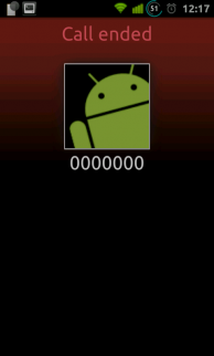

Also, have someone noticied the "24bpp framebuffer (truecolor display) driver"? I can't see the difference, maybe isn't working here, as i said above i've that interference problem.
Hmmm... I get you some apps to try. Just a moment.
EDIT: See this most excellent page for illustration, and get the test app there: http://www.curious-c...-and-dithering/ I may do some screen shots later if I have time.
EDIT2: Color is a very subjective matter. One might be more sensitive to it but the others not. I can even tell the difference with the default wallpaper in the 2 different bpp settings. You'll find below 2 screenshots attached that can demonstrate the severity of the banding problem of 16bpp framebuffer - click to see them in full size. Try use a 24bpp kernel and see the difference yourself.
EDIT3: BTW, you can use the following command in a terminal the check the bpp of the current running framebuffer:
cat /sys/devices/virtual/graphics/fb0/bits_per_pixel
EDIT4: The background should look like the last 2 images in a 24bpp screen.
  • Attached File  1.png   28.83KB   22 downloads
  • Attached File  2.png   21.84KB   23 downloads
  • Attached File  3.png   221.38KB   14 downloads
  • Attached File  4.png   2.85KB   12 downloads
Edited by ipaq3870, 30 May 2012 - 06:53 AM.
