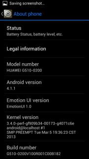

Hey guys, I have g510-0200 and I don't wanna void my warranty by unlocking the bootloader. So my question is, is this method wanna give me root access without installing a custom recovery and unlocking the bootloader. Well In my opinion if anyone has root than a custom recovery is very important. I really don't care about custom roms as right now not a single one is worth a try. Check screenshot.....

The thing is that with root metod when you flash the Chinese kernel & then root you actually have all the boot loader is unlocked at that point so you can & do lock it back with flashing back international kernel!
The real question is du the Chinese kernel case problems?
If not that is it really! You can play & after all flash back recovery & lock the boot loader so you still have the warranty!
It's posable & to unroot this way!
