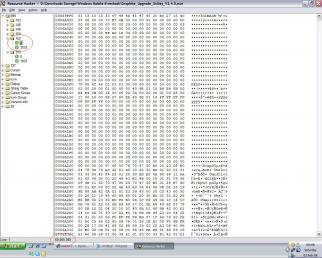

Hi everyone. I think many asian graphite owners are waiting for this. Here's one successful upgrade of asian graphite with UK ROM. Mine! :D The only setback is that I had to manually enter my mms and gprs settings after the upgrade as you will not have the asian 'O2 AutoConfig', 'O2 Connect', 'O2 Menu' (anyone converted these to cab files before so that it can be installed easily?).
But before I continue, I would like to state a disclaimer on the following procedures. I will not be held responsible for any bricking of your smartphones. And before you begin, please make sure that your battery is full.
  1. Dump your present ROM and keep it as a backup (I forgot this step and I don't know where to get the software for dumping my ROM, so no turning back for me :D ).
  2. Get your hands on the UK ROM file by searching at http://forum.xda-developers.com/showthread.php?t=335151
  3. Download Resource Hacker from http://delphi.icm.edu.pl/ftp/tools/ResHack.zip
  4. Extract these files and run Resource Hacker.
  5. Using Resource Hacker, open the 'Graphite_Upgrade_Utility_V3.4.0.exe' file.
  6. In Resource Hacker, select the following resource. Look at the areas circled in redpost-241364-1201887868_thumb.jpg.

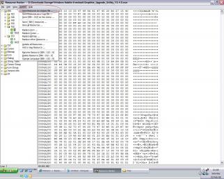

  7. Click on 'Action', 'Save Resource as a binary file'. post-241364-1201887895_thumb.jpg
