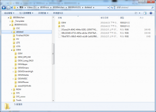

Guest twu2 Posted April 13, 2010 Report Share Posted April 13, 2010 (edited) hello twu2 Can you make this rom for the Russian language plz.? All the Russian community with 4pda.ru would be very grateful to you ;) It's difficult for me to do this, but using my script and wes58's romtool, you can try to build it by yourself. It's very easy, just following this documentation step by step: 0. get php win32 binary from here: http://windows.php.net/download/ and install it to c:\php\ 1. get sorg's dskdump.exe from here: http://www.modaco.com/content/i8000-verizo...60/dskdump-2-0/ 2. flash the official rom and choose the language you need, then use dskdump.exe to dump the rom to rom_dump.bin 3. get wes58's romtool from here: http://www.modaco.com/content/i8000-omnia-...ld-application/ 4. copy _Template folder to I8000NXXJD1, and follow wes58's documentation, copy and change the file we need for LZX compression. 5. put rom_dump.bin to I8000NXXJD1 folder, like this: 6. execute romtool.exe, choose 'Dump PDA (.nb0, .nb, .bin file)', and click the 'Select File' button to choose the rom_dump.bin, then check the option like this: then click 'Run' button, wait for a few minutes, you will get a result like this: 7. then choose 'Setting', click 'Start ExtReloc' button like: 8. change to 'Optoins' tab in ExtReloc, then change the option and like this: then click 'Save Optoons', then exit ExtReloc program. 9. extract files (include folder) from i8000lite.zip, you should get the environment like: 10. open a command prompt, change to the I8000NXXJD1 folder, make sure the php command work fine for 'c:\php\php.exe -v', then execute 'c:\php\php.exe -Cq i8000lite.php' like this: the result will like this: the script will move files we don't want to deleted folder like: 11. you can do some fine tune here, to delete some other files, change some registry, add some program.... (change the setting in zzzzMyMods folder, it's for English, some might change in different langaue) 12. return to romtool.exe, choose 'Build PDA (.nb0 file) tab, and Click the '...' button after 'Work Folder' to choose the our work folder (I8000NXXJD1, yes you need to choose it again, even it's already this folder), change the PDA version to what you like, and click the option like this (also change the pagepool size to what you want): 13. click 'Run', it will pop-up BuildOS like this: 14. click the green execute button, and wait for a few minutes, it should like this: 15. before you close BuildOS, here is the final stage if you still need to modify some files or some setting, just do it in 'temp\dump' folder.... 16. close BuildOS program, it will pop-up ExtReloc like this: 17. then just wait... maybe 5-10 minutes depend on you computer speed... you should get the result like this: 18. then check the 'Finished ROM' folder, you should get the lite ROM here: 19. flash it and test it... for cabs... there's no easy way or script to do it, you need to use 'WinCE Cab Manager' to create it or modify the one I created. here is the file include the script, setting, and zzzzzMyMods OEM. i8000lite_eng.zip Edited April 13, 2010 by twu2 Link to comment Share on other sites More sharing options...
