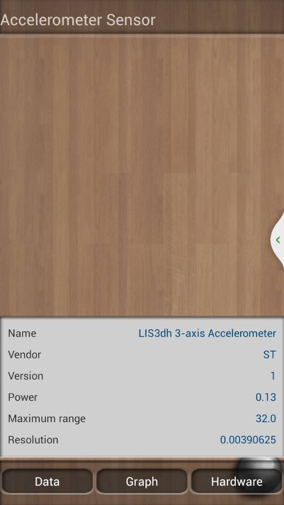

I ran SensorBox on Coolpad F1 running Jonzalvo's AOSP pure (a version from a while ago - not the latest) and it reports the same: LIS3dh
