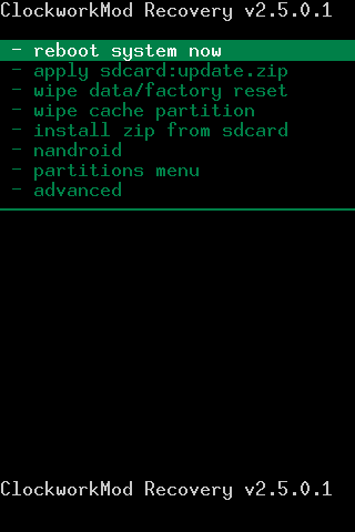

Guest Simon O Posted July 19, 2010 Report Posted July 19, 2010 (edited) Presenting, Clockwork Recovery for the T-Mobile Pulse. Now official supported! Installation guide: (easy) Download ROMManager from the market. Some roms may have this pre-installed. Run ROMManager and click "Install Recovery". Select "Huawei Pulse" when it gives a choice and ROMManager will automatically download and install the recovery for you. Installation: (difficult) How to install - Mac, Linux and OSX Download recovery-clockwork-2.5.0.4-pulse.zip Extract the archive. Put your device in bootloader mode - turn if off, then tap the powerbutton while holding the 'Volume Down' and 'End (Red)' keys Run the bat file to install recovery. Mac/Linux users need to do "fastboot flash recovery recovery-clockwork-2.5.0.4-pulse.img" to install recovery. If you want to download the image on it's own then you can do so with this link If you have any problems with the recovery image please report them to Koush on irc.freenode.net on channel #koush or contact him on twitter @clockworkmod Edited September 28, 2010 by flibblesan

Guest irvine Posted July 19, 2010 Report Posted July 19, 2010 Great news flibble! Doesn't look as slick as AmonRA, but at least we're making some progress :angry:
Guest Simon O Posted July 19, 2010 Report Posted July 19, 2010 Great news flibble! Doesn't look as slick as AmonRA, but at least we're making some progress :D Not sure how it's not as slick. Both have simple text based menus :angry: Clockwork has a much better file manager for selecting roms. No longer do you have to put them on the root of your SD.

Guest Speckles Posted July 19, 2010 Report Posted July 19, 2010 The GUI on all these recovery utilities is all the same - text based using the roller wheel. I don't like using that wheel. I want to use the touch screen! I realise that we might not have room for oodles of graphics, but we should be able to get better than what looks like DOS, even if it means storing some optional files on the SD card.
Guest Simon O Posted July 19, 2010 Report Posted July 19, 2010 Well he said it gets updates (Which doesn't make much difference) and that you maybe able to install and keep up to date while in Android OS. But what about other changes? :angry: Perhaps some to AppstoSD? Well in terms of updates it'll be a lot better and if you are a premium Rommanager user then you will be able to download and flash FLB updates in a new and cool way. For example, it'll show you the latest version being available as FLB-Mod-1.1 but there will be extras available also. Extras such as TMO-Kernel, Vanilla Framework etc. And you can select the ones you want and Rommanager will automatically send you to recovery and install the updates one by one. It saves me having to produce more than one rom for people. I can stick with one rom then produce additional updates for kernel, framework, launcher etc. The recovery itself: "Features of the recovery image include Nandroid backup, adb shell, mount USB storage, advanced update.zip options (ignore asserts and signature checks), and file browser (so you can place your zips in subdirectories and organize them). " and my favourite: Installation of recovery from inside Android. Allows for easy updates.
Guest Sl4yer Posted July 19, 2010 Report Posted July 19, 2010 I realise that we might not have room for oodles of graphics, but we should be able to get better than what looks like DOS, even if it means storing some optional files on the SD card. What's wrong with DOS?! :angry: I quite like the AmonRA layout. Simple and practical. Looks aren't important for this sort of thing IMO. Plus, it makes me feel technical!

Guest Speckles Posted July 20, 2010 Report Posted July 20, 2010 I quite like the AmonRA layout. Simple and practical. Looks aren't important for this sort of thing IMO.I agree, but I think the controls are lacking. I'm paranoid that i'll accidentally press the roller button instead of moving up or down and then selecting the wrong option (thankfully most 'dangerous' things have confirmations).
Guest JingleManSweep Posted July 23, 2010 Report Posted July 23, 2010 I agree, but I think the controls are lacking. I'm paranoid that i'll accidentally press the roller button instead of moving up or down and then selecting the wrong option (thankfully most 'dangerous' things have confirmations). You can use the "Volume Up" and "Volume Down" keys inside recovery mode to move the cursor, and I believe "Green (Call)" button acts as the OK action.
