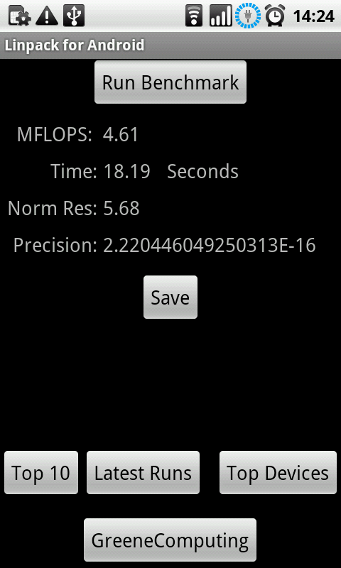

Guest kallt_kaffe Posted December 15, 2010 Report Share Posted December 15, 2010 (edited) Just for fun... more benchmarks at 729.6MHz when I turned off whatever I could think of like background data sync, automatic brightness, killed all unneeded apps etc... To make it a fair comparison, here's the result with the stock kernel under the same setup: . Edited December 15, 2010 by kallt_kaffe Link to comment Share on other sites More sharing options...
Guest kallt_kaffe Posted December 15, 2010 Report Share Posted December 15, 2010 (edited) Hmm... I just realized I've accidently overclocked the AHB bus from 200Mhz to 364.8MHz in the example above. Seems like AHB overclocking has very noticable effect on Quadrant benchmarks but I'm not sure it's safe to go that high. I'm going to try a little bit more conservative AHB overclock... EDIT: A more conservative AHB overclocking didn't allow me to go above 729.6 without freezing rather quickly. Linpack and Neocore isn't affected that much but Quadrant scores goes down. It's propably the file read/write parts in Quadrant that benefits from AHB overclocking. I'll propably make two kernels. One with safer AHB speeds and one that boosts the AHB speed from the 400MHz level and upwards. Edited December 15, 2010 by kallt_kaffe Link to comment Share on other sites More sharing options...
