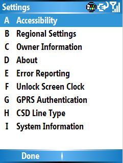

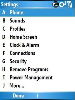

Hi all,
The weirdest thing happened to me today. I got up and turned on my SPV C600 as usual. I entered my PIN and went to change the phone into silent mode. So - as usual - I tapped the power button and I was presented with the Power Profile menu. However, where I would normally tap '6' to activate the Silent profile, there was no shortcut for '6'. The Silent Mode shortcut had been replaced with the letter 'F'!
Of course, I couldn't use the keypad to activate the Silent Mode because there is no single 'F' key on the C600! Whats going on???
I also tried the settings menu...
...messaging menu...
In this second messaing menu, there were no shortcuts at all!!!
...and even some 3rd party software - Smart Explorer...
Again, no shortcuts available at all
Each of these - and all my other menus - had been replaced with letters for the shortcuts or the shortcuts were missing all together!
Please help me because I really need to get those number shortcut keys back otherwise I have to do an awful lot of scrolling which is extremely time consuming!
Thank guys,
jameshpg

Hi,
I fixed it! Yay, back to number shortcuts now!
Turns out it was bluetooth related! On Tuesday I bonded with a Sony Ericsson K700 so that it could send me a file. When you bond, you are presented with 3 stages:
1) You+the person both enter the same passkey
2) You choose a name for the device
3) You select services
On the 3rd stage, the only service is usual Serial Port (not quite sure what that is! Anyone?), see below:
However, when I bonded with the K700, I was presented with 2 tickbox options; Services and Input Device. I ticked both out of interest and hit next. The file was transferred and I thought that that was all great. The 'Input Device' option must have been what changed the shortcuts because when I removed the K700 device from my Bonded Devices list, the menus returned back to normal!!! Yay!
So can anyone offer insight into what these "Services" are and do? I'm sure we'd all love to know!
jameshpg
You're absolutly right. :P
It's a bug that makes your phone think it's connected to a BT-keyboard. I found something a while ago but cannot remember from whom I copied this (my apologies).
Fix: Change the HasKeyBoard DWORD to 0 at:
HKEY_CURRENT_USER\SOFTWARE\Microsoft\Shell and reboot your phone. My
thinkoutside bluetooth keyboard still works and I have numbers instead of
letters.
So when your phone next time connects to another phone, leave "input device" unchecked or edit your registry afterwards... ;)
