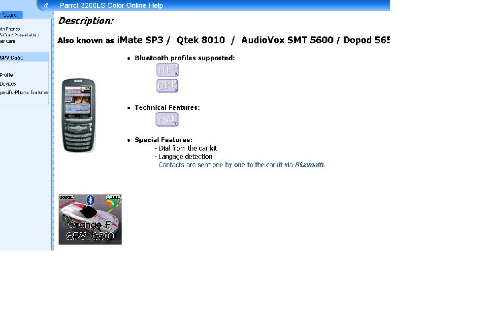

Guest DJ Pierre Posted December 6, 2005 Report Posted December 6, 2005 (edited) I bought the new ck3200 Parrot to use with a spv-c500. It works fine, the sound quality is good and no feedback whatsoever. I do have some issue's unfurtunatly: -Is there a usermanual online? I can't find it anyway and you only get a installation manual. -Can i mod the homescreen? I can connect to the parrot with my Bluetooth-Laptop and i see some folders, but i can't find the picture in the parrot'menu, whitch i succesfully send to 'pictures'folder on the parrot. I schrunk the picture to 160x128 and named it 'custom.jpg'. -Can i mod the ringtones? If yes, which audioformat is can i use? I tried Midi(for Nokiaphones e.a.), wav and mp3 but they won't copy to the 'ringtone'folder on the Parrot. Parrot doesn't recognise any of these formats. -Does the called-ID function work with an SPV-C500?(contact-pictures) It doesn't work in my case but maybe i'm overseeing something? -I had to copy my contact's one by one, is this normal in use with te SPV-C500? The Sync-all option is gray on my smartphone. I'm a bit disapointed about the quality of the operationbuttons, all buttons feel cheap and the scrollbutton has already fallen of(whitch i was able to push back in positioning). It operates way to heavy also. But it looks like a charm. Edited December 6, 2005 by DJ Pierre
Guest DJ Pierre Posted December 9, 2005 Report Posted December 9, 2005 I bought the new ck3200 Parrot to use with a spv-c500. It works fine, the sound quality is good and no feedback whatsoever. I do have some issue's unfurtunatly: -Is there a usermanual online? I can't find it anyway and you only get a installation manual. Yes, there is since yesterday. -Can i mod the homescreen? I can connect to the parrot with my Bluetooth-Laptop and i see some folders, but i can't find the picture in the parrot'menu, whitch i succesfully send to 'pictures'folder on the parrot. I schrunk the picture to 160x128 and named it 'custom.jpg'. -Can i mod the ringtones? If yes, which audioformat is can i use? I tried Midi(for Nokiaphones e.a.), wav and mp3 but they won't copy to the 'ringtone'folder on the Parrot. Parrot doesn't recognise any of these formats. -Does the called-ID function work with an SPV-C500?(contact-pictures) It doesn't work in my case but maybe i'm overseeing something? Doesn'twork with te spv, it does with Nokia, samsung, Sony-Ericsson and such. Bummer... -I had to copy my contact's one by one, is this normal in use with te SPV-C500? The Sync-all option is gray on my smartphone. There's no way to copy all at ones. One by one it is... I'm a bit disapointed about the quality of the operationbuttons, all buttons feel cheap and the scrollbutton has already fallen of(whitch i was able to push back in positioning). It operates way to heavy also. But it looks like a charm. <{POST_SNAPBACK}>
