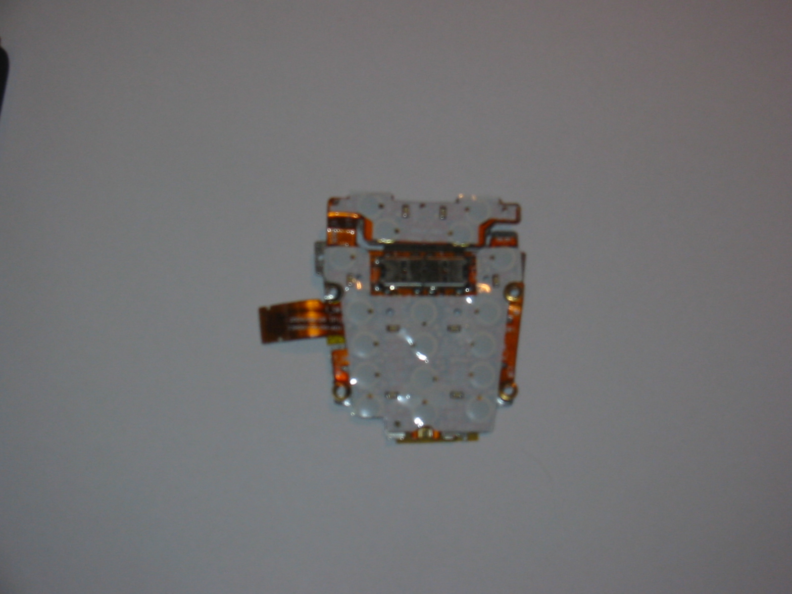

Guest fluffcat1 Posted September 23, 2005 Report Posted September 23, 2005 Hello everyone, First of all I would just like to say how great a site this some great stuff here for smartphones. Now the problem, The top left soft key on my phone isn't working, this is pretty much made my c500 useless as all I can do without that button is phone people. Does anybody know anythinng I can do that might be able to fix this problem? Any help will be appreciated. Cheers DVV :o If a hard reset hasn't worked and your phone isn't in warranty I have replacement keypads here or you could attempt a repair yourself. It's most likely the metal disc under the button that's either shorting or lost it's springy-ness. Richard

Guest fluffcat1 Posted September 23, 2005 Report Posted September 23, 2005 I know of one person who had a lot of buttons not working correctly on his C500 and a hard reset did fix the problem. He is unsure of what caused the problem in the first place. Plus HTC are *aware* of an issue with keypads - else why would there be an option on the website for stating the damage 'non responsive keypad - especially number 4'... It'd be very hard for water to get into the *keypad* assembly - it'd have to be immeresed and under pressure for some time for water to get behind the sticky plastic layer. The only part of the keypad that could realistically corrode is the connector on the end of the ribbon. They're not like Nokias etc where the keypress contacts are exposed, the contacts are covered in very sticky plastic. I have one with a ripped ribbon I might use for an experiment :twisted: Richard
