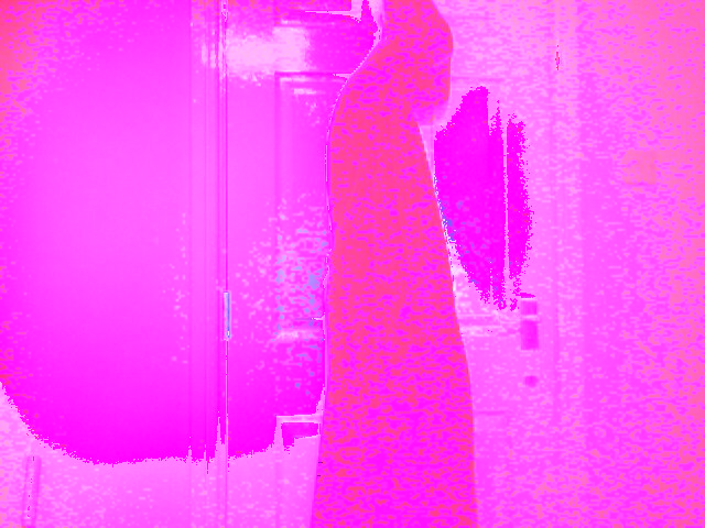

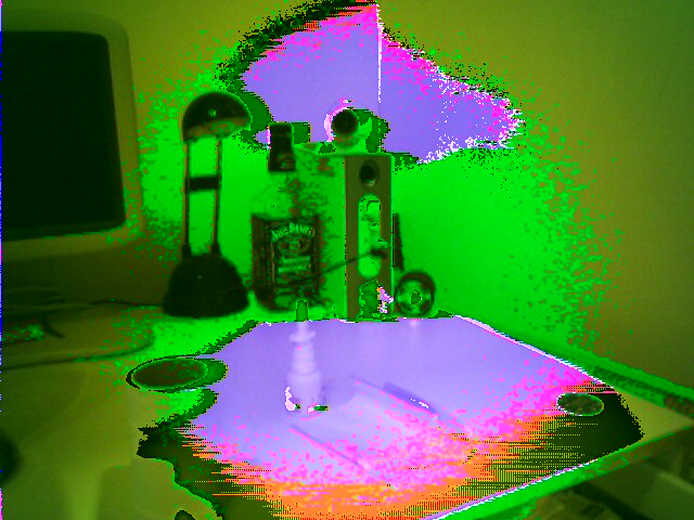

hi all, i recently obtained a c500 from a friend who had his orignal phone replaced by orange. the unit is therefore new. i went to try the camera out and it was rather sketchy, at first certain areas of light were pixelated and the picture was a slight green. so i started frantically searching forums for answers, i then tried my camera again, to my suprise it was fine and i took a few snaps to prove it. however whilst the camera was on it then flashed pink and now all my pictures are pixelated and pink :?: i carried out a hard reset hoping for this to solve the problem but the camera still see pink, any ideas, different software/update? i find it especially strange that the camera has worked, it would be easy to say it was broke but it has 'switched' itself back to being ok once
attatched are 3 photos showing the phones progression from orignal, to when things went 'fine' and then how they are now.

Possibly a loose connection to the board? Failing that a knackered CCD. Remove the aeriel cover and **gently** push down to the left and slightly above the camera lense and see if that makes a difference.
What is the warranty status of this phone?

i have tried changing all the settings, doesnt effect the quality at all... still pink.
sorry i missunderstand, how can i push down to the left and slightly above the camera lense?

i tried to remove the case to push the camera, however i didnt want to mess up anyhting in case i needed to send it back, i didnt really understand what clips i was push and such, so i just push down firmly on the camera as it sits in the case and bingo, problem solved! i know have crystal pics, thanks for your help
No problem, glad it's sorted :-)
