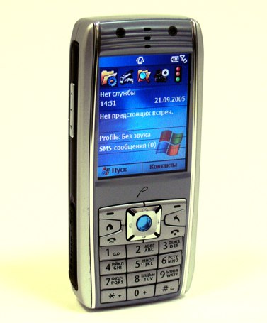

Guest maxpain Posted November 1, 2005 Report Posted November 1, 2005 (edited) I mean this one And this is my rover A little similar in exterior...but the same inside, i believe... Edited November 1, 2005 by maxpain
