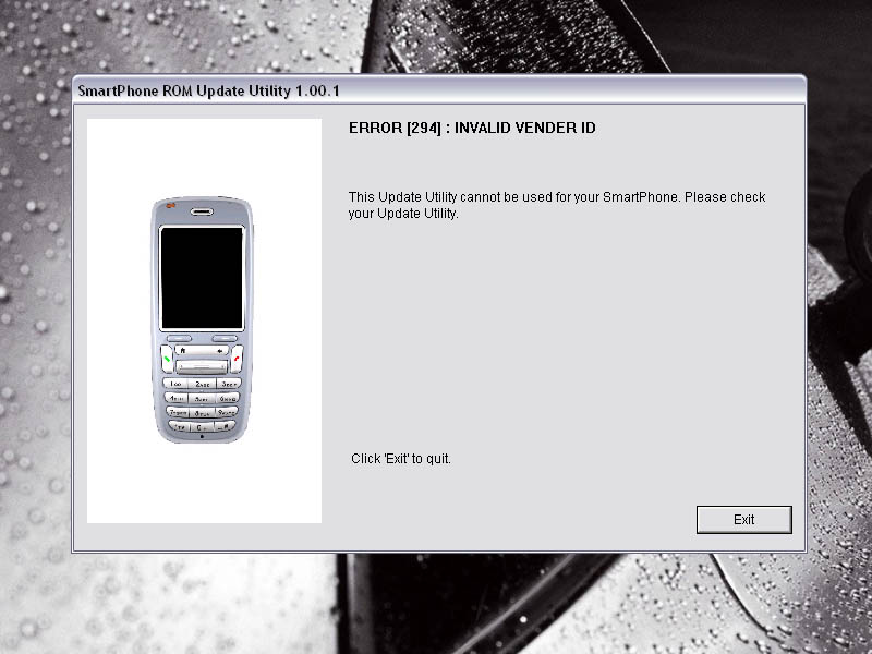

Guest vedtom Posted November 5, 2005 Report Posted November 5, 2005 (edited) I just download the latest ROM 4.2.10.3 from orange website to have media player 10.I backed up all my data to pc and start the update.My ROM is 4.1.10.3, ewerithing goes fine until the update starts, but after several seconds it stops and :"Error [294]:INVALID VENDER ID"... "THIS UPDATE UTILITY CANNOT BE USED FOR YOUR SmatrPhone.PLEASE CHECK YOUR UPDATE UTILITY! " :shock: HMMMM....just wondering WHY? :cry: Edited November 6, 2005 by vedtom

Guest chmod-uk Posted November 6, 2005 Report Posted November 6, 2005 I have read a lot of comments about new Orange ROM for c500.But none of them had any solution.Please if anyone knows a good link please help me...I would be beholden the one who could help me...Thanks <{POST_SNAPBACK}> Well you can bypass that with the typhoonnbftool but it should update seeing as its an orange rom and you have an orange phone? So i don't see where the problem is.
Guest vedtom Posted November 6, 2005 Report Posted November 6, 2005 Oh, ok...So my ROM version i think is:" Version 4.21.1088 (Build 14217) ".I have unlocked my phone already on Orange website.Can you tell me about "removing the network restriction"??Can this be a reason?Thanks
Guest Pondrew Posted November 6, 2005 Report Posted November 6, 2005 SPV-Developers tool opens a device for any rom (presumably from any region) so if you do find it's because your Orange SPV C500 is from a region other then Romania (10) then it should resolve it, but before we start going through how to use the tool can u check what the current rom is? Scroll down further in the About screen until you reach a number similar to either 4.2.1.2 or 4.2.10.3... this is the operator rom version I was asking about in the duplicate thread...

Guest vedtom Posted November 6, 2005 Report Posted November 6, 2005 So I went to Settings>About...under the processors type is writen " ROM update versions: Operator : 4.1.10.3 " Manufacturer:1.1.10.130 Microsoft: 4.21.14217.0 . . . I boght my phone from Romania, if is important.Shoul I look now after SPV Developers tool?
Guest cold_fire Posted November 8, 2005 Report Posted November 8, 2005 SPV-Developers tool opens a device for any rom (presumably from any region) so if you do find it's because your Orange SPV C500 is from a region other then Romania (10) then it should resolve it, but before we start going through how to use the tool can u check what the current rom is? Scroll down further in the About screen until you reach a number similar to either 4.2.1.2 or 4.2.10.3... this is the operator rom version I was asking about in the duplicate thread... <{POST_SNAPBACK}> I am from Romania and have done the update with the french ROM using the NBF tool .

Guest cold_fire Posted November 8, 2005 Report Posted November 8, 2005 (edited) So I went to Settings>About...under the processors type is writen " ROM update versions: Operator : 4.1.10.3 " Manufacturer:1.1.10.130 Microsoft: 4.21.14217.0 . . . I boght my phone from Romania, if is important.Shoul I look now after SPV Developers tool? <{POST_SNAPBACK}> If you bought it from Romania it won't work unless you use the NBF tool as the ROM is only for french C500 .I modified the update file following the instructions and the update succesfully installed. Edited November 8, 2005 by cold_fire

Guest vedtom Posted November 8, 2005 Report Posted November 8, 2005 Thanks for all the info..thanks for eweryone!Media player 10 is fine and my phone is working properly!!! ;) :D :D
