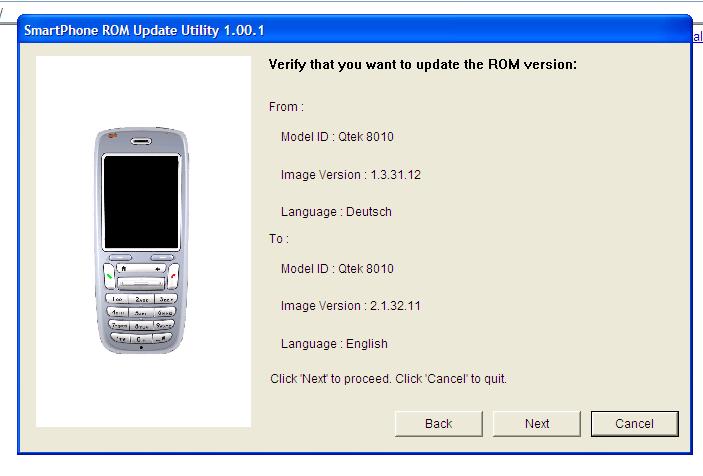

I would like to update my qtek 8010 and so I download a newer firmware, but when I tried to update it, everytime it fails.
There is a screen capture of my pc, so you can see that model ID is Ok, but I don“t know how it fails, and the fail is: ERROR[294]: INVALID VENDER ID
Any ideas?

Hi
You need to remove the operator info included in the ROM using the typhoonnbf tool from www.spv-developers.com
I had exactly the same problem yesterday !
