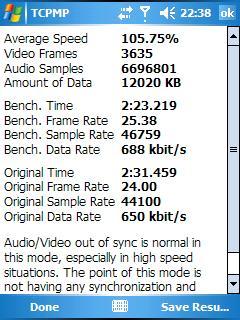

Guest Pondrew Posted January 9, 2006 Report Posted January 9, 2006 So, I decided to finally try and confirm if MDA Compact II (HTC Charmer) with it's Texas Instruments OMAP 850 processor at 195MHz can match the processing power of the MDA III (HTC Blue Angel) with the Intel XScale PXA263 at 400MHz. The tools used in the benchmark were everyone's favorite divx player TCPMP (version 0.71) and a freely available high quality (weighing in a file size of over 11meg!) encoding of the Matrix Reloaded trailer the file name of which is "RL_MQB_320x240_512_128.avi". The avi file was put on a high speed 1gb SD card which was subsequently used in each device. Having ensured I'd closed all running programs I ran the benchmark option in TCPMP (under File) for the matrix trailer on each device. My results were as follows (the higher the percentage the better, folks): MDA III (HTC Blue Angel): 157.43% MDA Compact II (HTC Charmer): 105.75% What does this mean? Not a lot. But it DOES support suggestions that the new MDA Compact II IS NOT as fast as the last generation of Pocket PC Phones when it comes to video playback.
Guest Pondrew Posted January 9, 2006 Report Posted January 9, 2006 Thought you might be interested to see the screen captures of the results from each. The left (in blue) is the MDA Compact II while the right (in grey) is the MDA III. Most significant I would say is the difference in how long the two devices took to do the benchmark (as this could be seen as representative of how fast the device is).
