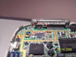

Guest usaussie Posted May 14, 2006 Report Posted May 14, 2006 I would like to thank Fluffcat for his tip re the 'reflowing' of the power connector. I had been having very little success at charging my MPx220 with anything. After I read Fluffcats posting I opened up my MPx 220 and found that all 3 pins from the connector were literally disconnected from the mother board. I lifted the pins very carefully, using a jewellers screwdriver, only to find that the soldering (soddering) quality was poor and that the PCB track was coated with crap. I have cleaned the track and the pins but didn't have a small enough iron to finish the job. I will buy something suitable and do so soon. Please see the attachment
Guest cergun Posted May 14, 2006 Report Posted May 14, 2006 I would like to thank Fluffcat for his tip re the 'reflowing' of the power connector. I had been having very little success at charging my MPx220 with anything. After I read Fluffcats posting I opened up my MPx 220 and found that all 3 pins from the connector were literally disconnected from the mother board. I lifted the pins very carefully, using a jewellers screwdriver, only to find that the soldering (soddering) quality was poor and that the PCB track was coated with crap. I have cleaned the track and the pins but didn't have a small enough iron to finish the job. I will buy something suitable and do so soon. Phone boards have surface mount components and they are ironed with hot air. I used to repair my Siemens S4 with a regular "hair drier". Try to move the pins to the closest position on the board and use a hair drier. But be careful, do not burn the components and the board ;) AT YOUR OWN RISK!!!!!! I just did several times and it worked. That does not mean it will also work for you... Good luck! Caglar ERGUN
