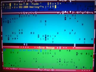

Guest awarner (MVP) Posted May 20, 2006 Report Posted May 20, 2006 I have a laptop infromt of me that belongs to a friend of a friend etc, The story goes is that this lappy was infected with the agobot virus and a possible backdoor attack has taken place. It appears that the bios is completely screwed because when the pc boots the screen is covered in random extended ASCII code with smiley faces etc as an example. The PC in itself is working but you can not visably any information in the bios screens so it is impossible to change any settings. After booting Windows XP loads ok but there are numerous blue bars running down the screen. The interesting bit is if you print the page out these bars are also printed (so presumably this excludes the graphics card from being at fault) Now for the fun, I am trying to find either a bios update or replacement chip, but unfortunately I can not find anywhere on the net. Because the lappy is made by a third party and branded by PCWorld american megatrends who make the board and ami bios will not offer any support or bios update. So off i trundle to PCworld (knowing full well what to expect) the guy in the technical desk know bugger all about what I was asking and kept going into the back room ask for more advice. After 30 minutes of getting nowhere I had to give up. All I asked them was how can I get hold of a bios flash or chip, they kept saying bring it in so they can look at it (and charge me the privilage) they then finally announced that the bios chip can not be changed. Just shows how much they actually know about their own products as this bios is a socketed PLCC type and so can be changed unlike the surface mounted type. So the question at the end of this sorry tale is.... Does anyone know where I can get AMI BIOS chips or updates?

Guest awarner (MVP) Posted May 21, 2006 Report Posted May 21, 2006 Here are some screen shots. Here's the bios Standard settings page Some motherboard and bios info, you can see the corruption of the screen after booting to XP.

Guest fluffcat1 Posted May 21, 2006 Report Posted May 21, 2006 (edited) PS I'd be really surprised if a BIOS update fixes this problem... ;) P I think it should... the corruption is down to the onboard video's bios being screwed IMO. Be interesting to see what it looks like in VGA / safe mode currently. EDIT - if it were a video ram corruption or overheating issue then the dos screen would display OK with minor lines visible in the characters ( but they would all be there ) and windows would look strange or not display at all - from experience with radeon 9000's that have had issues. Richard Edited May 21, 2006 by fluffcat1
