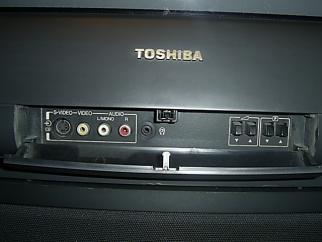

Guest mike-oh Posted June 6, 2006 Report Posted June 6, 2006 If you can post us pics of the back of your PC so we can see the outputs, and also a pic of any inputs on your TV then we can point you in the right direction. I'm pretty sure there'll be a way to do it even if its from SVideo to a phono plug input on your TV (the most basic way).
Guest mike-oh Posted June 7, 2006 Report Posted June 7, 2006 Hmmmmm. Short of that quite complicated vga to scart option (seems very awkward) i'm struggling for options. The main problem you have (correct me if i'm wrong anybody) but you have integrated graphics on your PC motherboard and the only video output is VGA. Most if not all graphics cards nowadays have s-video and often DVI out. Can your budget stretch to a new graphics card? How old is you PC? even a cheap card ~
