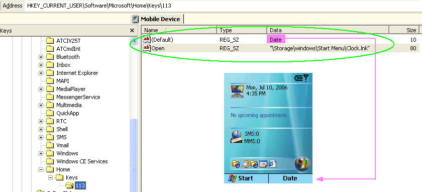

Guest gpcarreon (MVP) Posted July 10, 2006 Report Posted July 10, 2006 Maybe this will work: open Date and Time applet using shortcut. 1. Create an LNK (shortcut) with this code. Save your code as *.lnk 00#"\Windows\settings.exe" clock.cpl.xml 2. Move the LNK to your Start Menu folder 3. Enter the full path of LNK as 'Open' value data. Refer to this link for details. Don't forget to assign value to 'Default' http://www.modaco.com/TotW_Change_the_func...ey-t208536.html So for example on C550, it would be HKCU\Software\Microsoft\Home\Keys\113\Open Open = "\Storage\windows\Start Menu\Date and Settings.lnk" For better visualization, examine the screenshot
