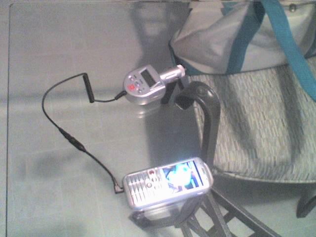

Guest grumpy_old_technobyte Posted September 3, 2006 Report Posted September 3, 2006 I'm using a 2.5mm adapter to connect to an FM Transmitter for the car. I've gone through quite a few in the past but I would recommend the type that use the cigarette lighter as a power source. The AAA batteried style will suck juice too quick. Once that silly law in UK is ridden, this might be a hot item again. (avoid the Sony DCCFMT3, the antennae is too weak)
