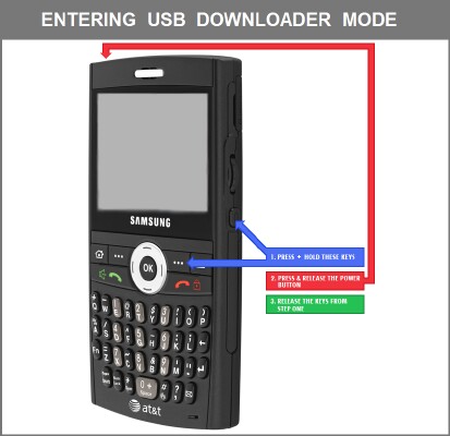

Guest mini_man Posted June 4, 2007 Report Posted June 4, 2007 I can get in boot mode : The fact that you can do that means your safe despite what these guys are saying. All you need todo is turn your phone off, hold down the camera button and shove a usb in. Wait and this will put your phone in the 3 coloured bootloader screen, next find an official update for your phone, from the carrier or samsung or something and run it. The upgrade program will recognise your device as a an i600 because its in bootloader, follow the procedure and dont touch anything untill its finished the upgrade and your i600 will be good as new! Seriously dont worry, just read up on rom upgrades, cid unlocking and read tons of forums about the upgrade and an upgrade procedure itself before you even touch an unnoficial installer lol. Hope it all sorts out!

Guest mini_man Posted June 4, 2007 Report Posted June 4, 2007 (edited) Bootloader instructions there. Presuming the i600 is the Blackjack (im not too sure) Here is a page about the official rom http://erms.samsungusa.com/customer/sea/js...amp;AT_ID=83176 Install this and it should restore your phone back to normal use and you can do your own rom finding from there. BTW. Bricked is the wrong term to use, if you can get into your bootloader your device is therefore functional not bricked. Edited June 4, 2007 by mini_man

Guest galinha Posted June 4, 2007 Report Posted June 4, 2007 So the i600 is a completely different device all together? Ok sorry that could of been disasterous. http://wiki.modaco.com/index.php/Samsung_i600 Modaco wiki has rom links would that be suitable? The problem is not how to enter in the bootloader is the same as I600 , the problem is that the phone is not recognized by the computer ! The phone starts , i can go into the bootloader , but i have now a Usb Downloader Xcingular 1.2 , and not Open 1.1 I need a full flash...and i dont know how to do it,
Guest mini_man Posted June 4, 2007 Report Posted June 4, 2007 That shouldnt really matter should it? Active Sync wont recognise your phone because its in bootloader. If your computer recognises a device is plugged in and you got the new hardware found. windows mobile device etc when its plugged into usb via the bootloader then an upgrade util should work fine. Have you tried one yet?
Guest orcinus Posted June 4, 2007 Report Posted June 4, 2007 Of course it should matter... It's an altogether different firmware loader and a different boot loader! Firmware updates meant for i600 with Open 1.1 loader talk to Open 1.1 loader. Firmware updates meant for i607 with Xcingular 1.2 loader talk to Xcingular 1.2 loader. You can't mix and match! Well, actually you can, but it's a one way trip... I think there was a standalone flasher utility floating around GSMHosting somewhere (i think) that you could feed a firmware of your choice. Maybe you could try looking that up.
