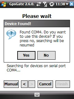

Guest tsutton Posted January 23, 2008 Report Posted January 23, 2008 (edited) Here's my writeup on getting GPSGate to work with MDA Vario III and sharing your GPS with other phone. With an very interesting outcome! Phones and software used in this example may not apply to yours but I believe it should work with other phones as long as it has similar operating system: Phones: - MDA Vario III (WM6) - SPV C500 (WM6 Smartphone) Software: - GPSGate - http://franson.com/gpsgate/ - GPSID - http://www.modaco.com/content/Smartphone-S...-on-Smartphone/ - Cameraware - http://www.cameraware.net - GPS Test - http://chartcross.co.uk/products/WM00002_details.asp Install GPSGate on MDA Vario III. Ensure that Bluetooth is turned on. Upon first loading of the GPSGate software, you will have a Wizard popping up. Ensure that "Wired or built in GPS" is the only thing selected. All other checkboxes are unchecked. Click ">" It will search for it and a prompt box will pop up saying that COM4 is found. Click Yes to use it. Ensure that "Share over Bluetooth" is checked. All other checkboxes are unchecked. Click ">" On the Summary page, you should have the following listed: Click the Finish button. On the "Input" tab, you should see the GPS status, saying that there is an GPS data and is running OK. The icon should turn green when there is a valid position. On the "Output" tab, the "Active Output" should have the following listed: When you've done with this, you need to ensure that this GPSGate software is STILL running in order for the other phone to see it and have "Serial Port" to work. Now the software... Make sure that both phones has Bluetooth turned on and is discoverable. On the SPV C500, do a scan for a new device via Bluetooth manager. It should find your MDA Vario III phone - add it. It will ask for the passkey. Default passkey is 0000 but if you used another code, use it to set it up. Ensure that the Outgoing COM port is set to COM6 for the phone that you've just paired with. On the MDA Vario III, it will alert you that another phone is trying to add you - accept it and enter the same passkey. Once done, turn off Dial Up Networking on this phone while on the other phone, turn on Serial Port. Both phone are now linked to each other. Install the Microsoft GPSID software to SPV C500 and set it up to: Program Port: COM6 Hardware Port: None Hardware Port Baud Rate: 9600 manage Automatically - checked On the MDA Vario III, ensure that GPSGate is running OK and with the GPS locked in a valid position. To test to see if GPS works, I am going to use GPS Test as an example on my SPV C500 phone. Load up GPS Test and go to Menu -> GPS Settings. Ensure that the following settings are set: Click the Save button to save the settings. Then close & open GPS Test. It will then try to find the GPS Unit and when found, it will get a GPS fix, where it will get the GPS data from the MDA Vario III as seen on the screenshot below from my SPV C500 phone. And for Cameraware: Things to be aware of: 1) If the phone with the GPSGate running goes into "sleep" mode, i.e. screen turned off by itself, GPSGate WILL stop working. Easy fix: turn off sleep or increase the timeout. 2) A VERY weird issue I've noticed... when the 2nd phone (i.e my SPV C500) get rebooted, it will never make the GPS connection again. It's as if it has lost the Serial Port connection. I can't find a way round to this apart from a hard reset on the phone (yes, harsh!!). Even deleting and re-adding the pair, the Serial Port never comes up. GPS test just sits, saying "Looking for GPS unit". This is confirmed when using Cameraware, it can not find anything at all. The only way for this is when you firstly made the pairing, and by not rebooting the phone, it will see each other okay. GPS test works. Cameraware works ok. But after a reboot... pow! Gone. I have no idea if it's to do with my SPV C500 phone or the operating system. Or a bug with GPSgate or something else? No idea. Any suggestions, anyone? In the meanwhile, I will be trying with my other phone, MDA Vario I and see if the issue exists or just my SPV C500 phone that is having this issue. Comments, feedback, suggestions, etc are always welcome! Edited January 23, 2008 by tsutton
