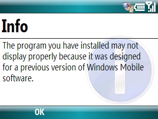

Well...Here are the steps that I made:
1. Run Paul's program from this website:
http://www.modaco.com/content/Smartphone-Standard-News/262074/Samsung-Blackjack-II-GPS-ACTIVATED/
2,3. Then I got this it was designed for a previous prompt and shows it was installed successfully.

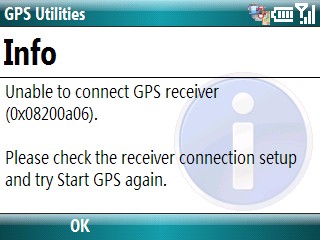

4,5. Then I used GPS Utilities to test whether the gps has been activated, set it to COM4.
6,7. Then I chose Start GPS, I got the failure information.
8. Even in Google Maps I can get pretty the same information.
PS, I tried staying in the cold weather outside for hours and it did not work, and I believe my trouble is not the signal strength of the satellites but no GPS hardware detected.
Could anyone tell me whether this is the same as yours or where I got wrong?

Why install the hack?
Many (including myself) are getting Google Maps (with 'Set By Windows' setting)
and Windows Live Search (with Intermediate Driver setting) to work out-of-the-box
with no hacks. Many are now reporting using Garmin as well with the Intermediate Driver.

I had the same problem. I did a hard reset and like magic everything seemed to work.

If you guys read the threads you would know there's a built in GPStest app in the BJII. All you have to do is cut and paste the shortcut to the app in your sart menu folder. It's available for download from the GPStest thread....
It can be used to jump start certsin apps. Google maps an windows live search should work without it though. If you installed other hacks i suggest a hard reset and start from scratch first application unlocking the phone thoroughly.

Basically I have mentioned all you have to do. Hard reset. Then apply the unlocks. Then apply the gpstest shortcut to you start menu folder. No other hacks. Installing the other hacks causes the gps chip to fail..another forum member has mentioned this in another thread " thelostsouls thread of tips" covers all this. I too had to hard reset my device.. In fact 5 times.. In which 3 of those the gps worked. You have to install methodically or the gps seems to fail to work. There's no need for hacks at all.. They only stuff the device. Having installed the other hacks is your problem. Without a hard reset there's registry entries that conflict with the clean install of what you actually want. If you use good backup software you won't have to spend ages setting everything back up again.
How did you hard reset??? Are you sure you did this properly? Its basically a reset of the device putting it back to factory settings and wiping all data from the devices memory.. All settings are wiped bar the standard AT&T ones. if you hard reset and even placed gpstest shortcut into your start menu folder I can gaurentee it will work without even unlocking... You must stand outside to get a lock... Not indoors!!!

On the same note, It took me a while to finally get my GPS working, I installed the hack and then put in the shortcut to the GPS test. It would not work in Google maps for the longest time. I eventually uninstalled google maps and reinstalled it and it worked right away. Maybe this will help some of you.
Cheers to the moderators for a great hack!

I can't seem to get the gps utilities to work either, all other gps apps. work? I get the same error "unable to connect gps receiver" I would really like to use the gps utilities too, this sucks!

This may be the cause for most of the issues! in order for the GPS to work it should be set to set by windows(via start>setting) I had the same issue until I saw it war written somewhere, changed the settings and worked right away(had to be in an area with good reception first) now even works perfectly with garmin Mobile XT(love that program)

As far as Google map, there was no special setup for it - we just simply used the defaults and it worked ONLY AFTER going to "Remove Programs" and removing the COM4 hack.
We could never get the GPSID application (the utility) to come up (again, because we're not using Win2003Mobile) We downloaded GPStest which showd that the GPS hardware was working. Uninstall of the hack allowed Google Maps to recognize the "out of the box" hardware and setup.
Hope that helps
Mike
