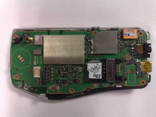

Guest awarner (MVP) Posted June 11, 2008 Report Posted June 11, 2008 Problem is it's not the taking apart it's more trying to change the backup battery. Here are some internal pictures I took, as you can see from the picture the battery bottom/left )first image) is not only soldered to board but the tabs it is connected with are spot welded to the battery making identification vary hard as the information are under the tabs. Wonder if it's worth giving HTC a call for repair?

Guest Mysterious Stranger Posted June 12, 2008 Report Posted June 12, 2008 Problem is it's not the taking apart it's more trying to change the backup battery. Here are some internal pictures I took, as you can see from the picture the battery bottom/left )first image) is not only soldered to board but the tabs it is connected with are spot welded to the battery making identification vary hard as the information are under the tabs. Wonder if it's worth giving HTC a call for repair? Looks like the standard cell HTC use accross many models. Panasonic ML414RM/F9A - DigiKey P003CT-ND http://dkc3.digikey.com/PDF/C081/P2214.pdf HTC will write the board off and quote for replacement. Seriously. :( Backup batteries are not 'mission critical' to the phone booting though - nearly all my candybar HTC devices have a dead one and work fine I just need to sync everythime I change the battery / sim etc - what makes you think this is the issue? I dunno awarner..maybe getting in touch with HTC would be the next step. I'm just a bit peeved that I may now have to pay out goodness knows how much just to get a few photos off my Lobster and the pics might disappear during repair anyway, if they haven't already. Thing is I did buy another Lobby off eBay a while back for about £16 as a backup so I am not without a Lobster. Plus, I have a spare one to smash apart if need be as I broke my very first one accidently. I think this has made me realise just how important it is that I should always back up my pics and stuff....just incase of unexpected problems like this ..... :D JS A white screen is usually a loose LCD ribbon. Again, not mission critical for the phone to boot. Are you sure the device isn't booting, you just can't see it? What about if you connect it to a comp.? Anything? HTC will wipe the handset during any diagnosis / repair anyway. Dissassembling and checking connections would be your first bet. M.S

Guest awarner (MVP) Posted June 14, 2008 Report Posted June 14, 2008 Looks like the standard cell HTC use accross many models. I've only really looked closely at the MPX200 which is a much larger battery. Wonder if it's worth sacrificing my C500 or an old SPV? haver to dig them out of storage but then again there is still no guarentee that this will fix the phone. As for my thinking, it's more of a try and see incase they have done something strange with this device when they designed it. I know my C500 battery is not good but I'm just thinking how damaged the battery may be as such. It's just strange how this device gives the white screen you normally associate with a duff device flash and as above none of my PCs see it XP and Vista.
