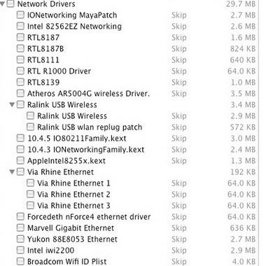

Hi All,
In the spirit of finding workaround for mic-in and headphone out, i just got this el-cheap'o usb audio dongle (PD-552) which i read somewhere on osx related forums is working with no problem, some know it as c-media usb 3d sound or comodow usb 3d sound or biostar usb sound.
Unfortunately this (kind of) doesn't work on mine. When i plugged it in, I open the sound section in SysPref, it was detected as USB VoIP for a while (in Output as well as Input), but after couple of seconds its gone...
I checked the console log, and see that it kept saying 'IOUSBFamily is having troung enumerating a USB device' and ended up with '... was not able to enumerate a device'.
Have anyone use this kind of usb audio device? or is there an kext that i should install? I tried to google'd around for mac drivers but couldn't find any because most people said it should be working ootb..
Advice and help would be much appreciated :D thanks in advance.

In the spirit of finding workaround for mic-in and headphone out, i just got this el-cheap'o usb audio dongle (PD-552) which i read somewhere on osx related forums is working with no problem, some know it as c-media usb 3d sound or comodow usb 3d sound or biostar usb sound......
UPDATE: So frustating, after re-plugin couple of times, the device is detected, sometimes as USB VoIP device, sometimes as Unknown USB Audio device, but still no sound out of it nor go in. So 10.5 knows that it is an audio device, its just that it don't know what to do with it :D
After more googling, i've come to a conclusion that this kind of usb audio is not supported in 10.5.x, the success story only happens in 10.4.x and somehow Apple did something with AppleUSBaudio.kext in 10.5 which made this kind not working anymore.
so...for now, maybe its better not to buy USB audio based on C-Media chipset, usually known as C-Media usb 3d or Comodow usb 3d or BioStar usb sound until someone can help patch the 10.4.8 JaS AppleUSBaudio.kext to 10.5.x (?) unless...you're brave enough to trivially replace your currently stable already wind with kalyway+paul's guide with 10.4.x distro :D
there goes my us$12 usb audio...

Guest elalitte
Daft question ... but it must be asked ... you have turned the wifi card on using Fn + F11 (or similar) havent you?
Yes, I've tried but it does nothing :-/
