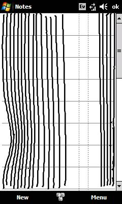

Guest Turborepu Posted April 17, 2009 Report Posted April 17, 2009 (edited) ok i have been having issues typing lately. i press the s key many times when i mean to press the a key. so i re calibrated the screen.. still s prob. today i tried to recalibrate again with a toothpick.. same deal. so i decided to draw on my notepad to see how far off the calibration is.. here is what i found. the screen is calibrated fine except for the lower left quarter. i will post a screenshot so you can see what i mean. as you can see in the pic there is a sort of dent on the side.. i made those lines using a ruler. so the pen touches the screen at a certain point but the screen registers it like 1\8 - 1\4 inch off almost.. but only for that area. any idea if its software related or hardware.. tia.. Edited April 17, 2009 by Turborepu
Guest maf107ezk0 Posted April 17, 2009 Report Posted April 17, 2009 It`s definately hardware... Sorry to tell you, but I think you need a new screen/digitizer :excl:

Guest mikeslackenerny Posted April 17, 2009 Report Posted April 17, 2009 ok i have been having issues typing lately. i press the s key many times when i mean to press the a key. so i re calibrated the screen.. still s prob. today i tried to recalibrate again with a toothpick.. same deal. so i decided to draw on my notepad to see how far off the calibration is.. here is what i found. the screen is calibrated fine except for the lower left quarter. i will post a screenshot so you can see what i mean. as you can see in the pic there is a sort of dent on the side.. i made those lines using a ruler. so the pen touches the screen at a certain point but the screen registers it like 1\8 - 1\4 inch off almost.. but only for that area. any idea if its software related or hardware.. tia.. I have a similar problem (for the last 3-4 days). Initially, there was no problem. But maybe exposure to heat (aka fan exhaust from my laptop) could have done this? I drew the lines trying to rougly overwrite the straight lines in the Notes.
