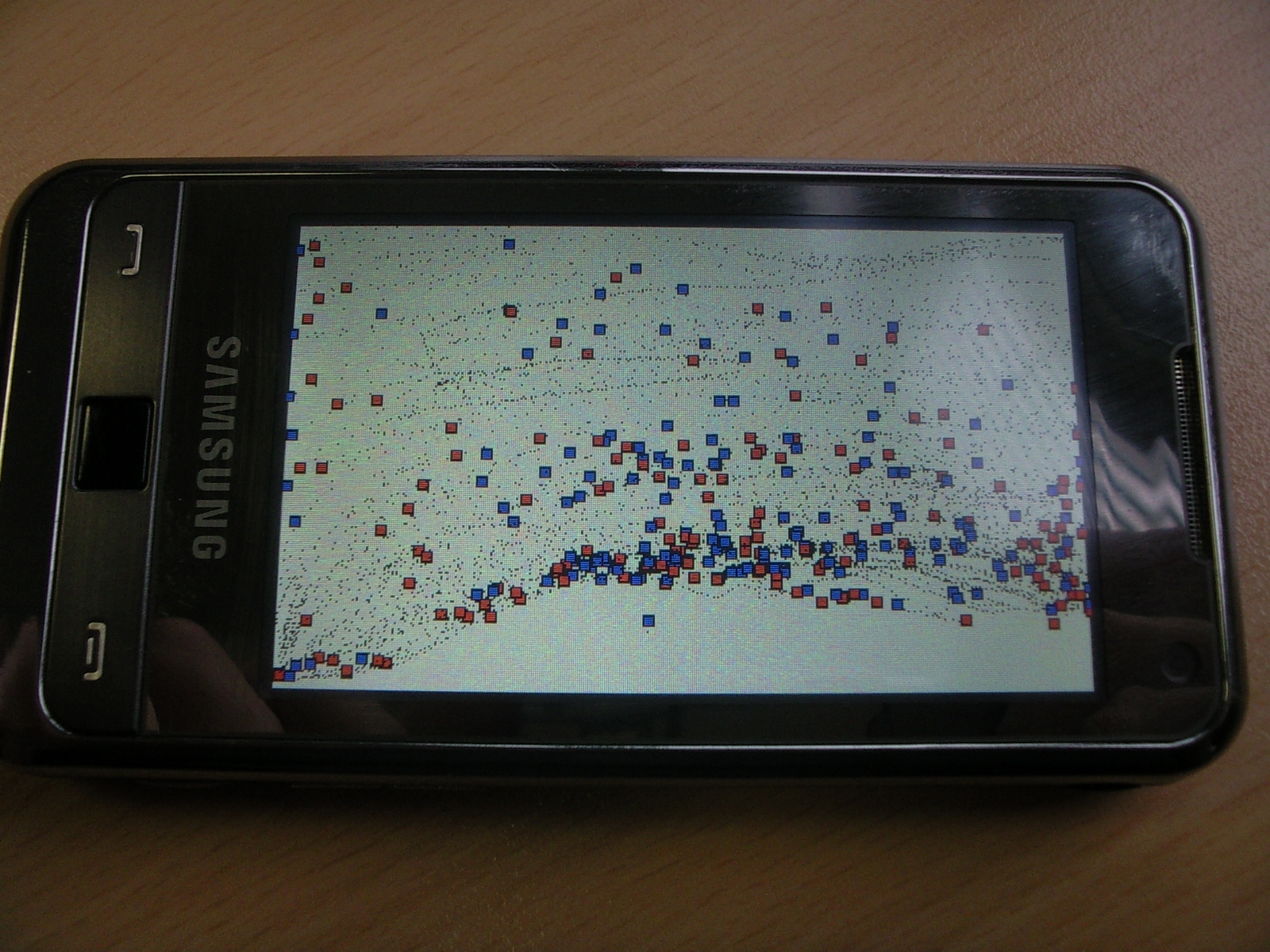

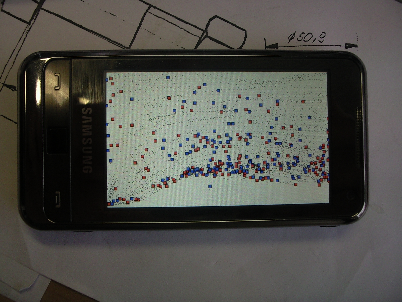

Guest srauf Posted April 20, 2009 Report Posted April 20, 2009 Hi there again! I tried the #0*# diagnostic tool. It shows how much of the screen is unalinghed. Here are my screenshots:
Guest cenzo Posted April 20, 2009 Report Posted April 20, 2009 I also have the same issue and now i cannot align the screen. thank god sectors h1 6.5 rom skips this part. Also ran the same test and similar issue however the middle of the screen on my phone is the problem area. I hope someone has some advise please.
