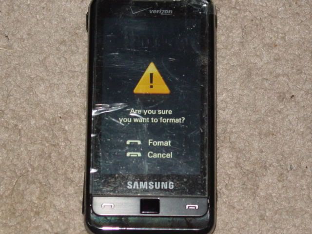

Guest xPosTech Posted April 23, 2009 Report Posted April 23, 2009 (edited) Success!!! Pressing on the outside of the Call and End keys did the trick on both phones. There is apparently a new Hard Reset routine coded into my FRU and the flash to CC20. I've never seen this screen before. On my original BJ28 firmware the screen was similar to the software initiated HR. But this FRU also has BJ28? This is the FRU. I haven't done a Hard Reset to my phone since putting on the complete Zagg InvisiShield film. I can see no overlapping edges on the Navigation key. The FRU has only the factory film cover on the screen and chrome portions of the case as far as I can see. dwallersv you da Man! Thanks ever so much. Now I get to spend some more time on the phone with Verizon explaining why I'm sending their FRU back. :excl: Ted Edited April 23, 2009 by xPosTech
