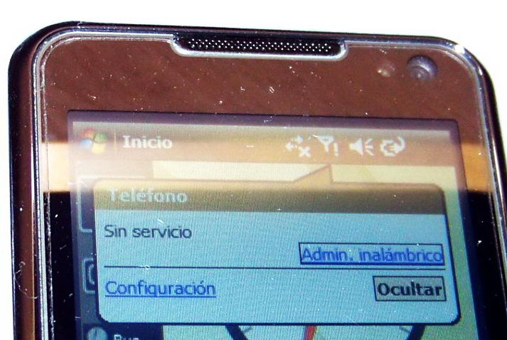

Hello, please I NEED help! Sorry if I’m out of topic but I’m trying to find some answer to my problem and nothing jet...
I got my omnia i900L running perfect with DXIA5FRL for 3 months but a few days ago without do nothing especial or drop the phone, just lost the signal (no service) and a admire symbol (!) is near the antenna signal. I did a hard reset, unlock by code and unlock with NSPRO box but nothing, just when restarting the signal was shown full but only for a second, them los signal again and the admire symbol.
Is anybody please helping me with this problem? Any sugestion please? Thanks very much in advance and sorry my bad english.

I had this after swapping to custom ROM, reboots didnt help ..
I solved it by turning everytihg off in the "wireless manager" changing the setting to my service provider and turning the phone part on in the "wireless manager"
