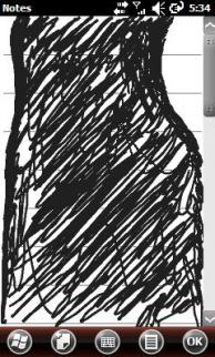

Guest gheorghe vasile Posted October 10, 2009 Report Posted October 10, 2009 In the picture bellow i draw in notes the screen how it response to sensitivity. i try also from my setings to recalibrate but don't work. i will try also the favorites hacking. Soory for my english
Guest jonboyuk Posted October 10, 2009 Report Posted October 10, 2009 I see....well to be perfectly honest - if the favourite hackings doesn't work then it sounds like you have a hardware fault. I cannot see that a flashed ROM of any nature would disable areas of your screen..... Looks like you may be looking at a new digitiser. Check the sticky threads for a guide on how to purchase and replace the screen. (It's really easy).
