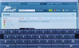

Guest AcerDroid Posted December 31, 2009 Report Posted December 31, 2009 (edited) Sorry for the english but this is really helpful!! I've repacked Paul's superboot cuz I think it maybe useful to others. This is Paul's image that I just tweaked removing the last line in the /default.prop. Heres what: smaller fonts (real desktop scale, ro.sf.lcd_density=160, 120 is too small and stretched) bigger screens browse the internet like on desktop (less horizontal scrollbars, no more image stretchings, less zooming) and more!! Poorly written apps will suffer small screen bug like ebuddy, dxtop, etc. (i dunno others) Home app has a bug when you try to switch between workspaces/desktops that will cause it to close, you can try other home like OpenHome or others Browser, Android Market, GMail, GTalk, and other apps has more space and works really great!!! if you like smaller keyboard, this is for you some apps are confirmed to be faster because my setup makes images/icons on UIs to not stretch because the scales is native (desktop scale) Just download Paul's superboot then overwrite the liquid.superboot.img attached here: liquid.superboot.zip I recommend you to do: "fastboot-linux -i 0x0502 boot liquid.superboot.img" to try it then if you want it permanently, run install superboot Comparison of old Liquid to my new setup You can see more apps because of smaller fonts Browsing the Market is really cool! The keyboard is smaller but still easy to use for me Real desktop experience, no more horizontal scrolling, no stretched images, faster scrolling Portrait keyboard offers bigger screen on your apps HOW I DID IT I followed every thing and used perlscripts (unpack-repack) here http://android-dls.com/wiki/index.php?titl...ack_Boot_Images I also used behnaam's mkbootimg http://romraid.com/behnaam/liquid/mkbootimg Unpack*.pl the superboot image (liquid.superboot.img) edit what you want on the ramdisk folder Edit the repack*.pl then append "--base 0x20000000" to mkbootimg repack.pl the kernel and ramdisk folder Using Hex editor (bless or ghex) Copy the first 12 bytes from the original liquid.superboot.img and paste it on your new boot image and it should look like "ANDROID!pk!" Boot it and have fun :) Now I am expecting Apps on SD or Boot from SD modding here, If you succeed, let me know ;) I want it also! Also you may look here if you want cheap but durable capacitive stylus like mine http://cgi.ebay.com/ws/eBayISAPI.dll?ViewI...e=STRK:MEWNX:IT I also ordered USB OTG mini to female USB adapter so I can plug my keyboard whenever someone already enabled USB Host mode in Liquid http://cgi.ebay.com/ws/eBayISAPI.dll?ViewI...e=STRK:MEWNX:IT Edited December 31, 2009 by AcerDroid
Guest goa200 Posted December 31, 2009 Report Posted December 31, 2009 while it does look nice it screws up so many apps and keyboard apps it just aint worth it tbh. nice work though
Guest lucian785 Posted December 31, 2009 Report Posted December 31, 2009 Nice work! Can you upload a video for a little demo?
Guest AcerDroid Posted December 31, 2009 Report Posted December 31, 2009 ya i am willing to demo the uses however i dont have any device to record one except my liquid so sorry :)
Guest Ogglord Posted December 31, 2009 Report Posted December 31, 2009 (edited) It's very easy to test, I just tried it without flashing ofc. It was nice, perhaps too small sometimes but much more screen space. Icon spacing needs to be smaller. And scandinavian keyboard rendered far too small, most native apps worked except youtube player. 50% of the games was played in ~half the screen. And so on, but still nice to test. edit: nice work btw Edited December 31, 2009 by Ogglord
Guest AcerDroid Posted December 31, 2009 Report Posted December 31, 2009 It's very easy to test, I just tried it without flashing ofc. It was nice, perhaps too small sometimes but much more screen space. Icon spacing needs to be smaller. And scandinavian keyboard rendered far too small, most native apps worked except youtube player. 50% of the games was played in ~half the screen. And so on, but still nice to test. edit: nice work btw thanks :)
