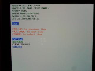

Guest nexus one Posted February 15, 2010 Report Posted February 15, 2010 I have google htc passion, unroot. I can't flash rom in the sticky thread http://android.modaco.com/content/google-n...-the-nexus-one/. If any one have the official rom for this, please help. I also glad if anyone clarify me about this model. Thanks.
Guest joners Posted February 15, 2010 Report Posted February 15, 2010 I have google htc passion, unroot. I can't flash rom in the sticky thread http://android.modaco.com/content/google-n...-the-nexus-one/. If any one have the official rom for this, please help. I also glad if anyone clarify me about this model. Thanks. Can you not flash the stock rom images found here... http://android.modaco.com/content/google-n...insecure-himem/ Hmmm looks like you have the engineering spl as well (i think!)
Guest Paul Posted February 15, 2010 Report Posted February 15, 2010 You should be able to flash any of the ROMs in the sticky post, as you have a S-OFF ENG bootloader! P
Guest nexus one Posted February 15, 2010 Report Posted February 15, 2010 (edited) You should be able to flash any of the ROMs in the sticky post, as you have a S-OFF ENG bootloader! P I am not sure if this phone is for Verizon or not? Because after flash by this method "Just download it, put it on the SD card named update.zip, launch recovery (power on with volume down held), press power and volume up when the warning triangle icon appears then select 'apply update.zip'." for all the rom you attached, the result is "verification fail". I also can't use fastboot to flash the image because it is always hang on <waiting for the phone> even windows detect the phone is android phone after I update the usb driver for it. If the phone turn on it stuck on three bots on skate screen. Update: I did it. It can be flash by fastboot now. And after flash boot, recovery and system image it can start. Thanks for your help. Edited February 16, 2010 by nexus one
