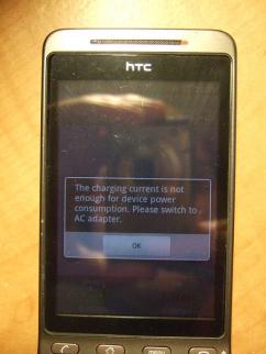

Guest arclife Posted March 4, 2010 Report Posted March 4, 2010 (edited) The Hero can obviously monitor power useage, and what is coming in - so maybe with a bit of software tweaking, it can be done. (edit: or maybe it isn't that clever, it just knew it was on usb therefore ~500mA tops, and knew consumption was higher than that) Edited March 4, 2010 by arclife
