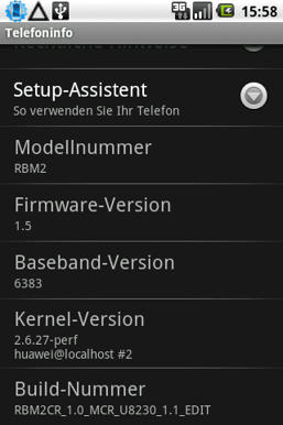

This Rom and Superboot Image is only for the RBM2 U8230 device without the december update!!!
This Rom is based on the RBM2 U8230 Stock Rom and the MoDaCo Custom Rom U8230! Big Thanks to Paul, McSpoon and all the other forums!
The Rom is only with German and ?French? language! <_<
The changes are the same like the MoDaCo Custom Rom U8230 Vanilla Style but without RoadSync! :(
A2SD is also included and works fully automatical! Create a EXT2/3/4 (3 recommended) partition as your second partition to use. If you partition it with the AmonRa Recovery you have to delete the swap partition or your device will not mount the sdcard correct! - It's like the MCR and the Pulse! :mellow:
RBM2 CustomRom Download: RBM2CustomRom_1.0_without_Roadsync_MCR_U8230_Edit_1.1-signed.zip
Edit: On the HomeScreen are the widgets "beautiful widgets, facebook and the battery widget" - they are not included!!!
