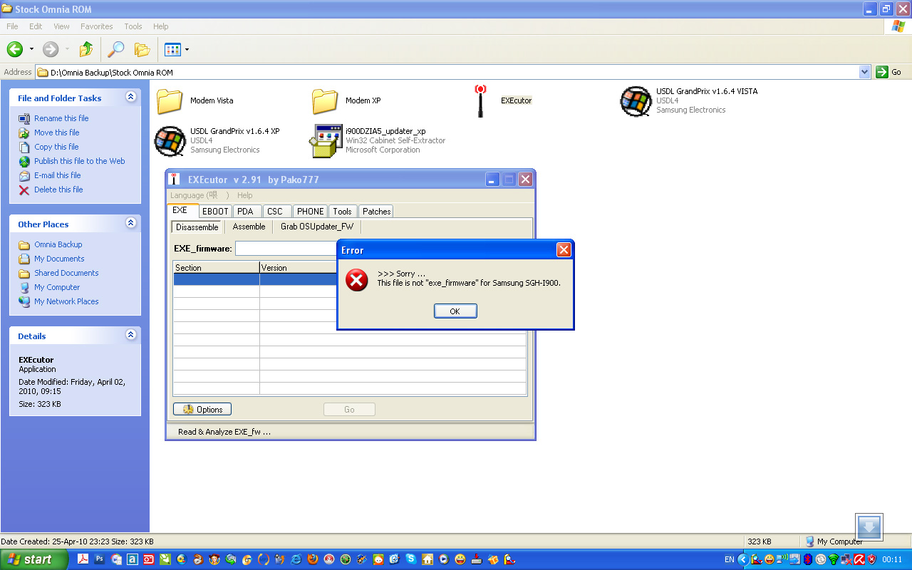

Guest anthony0050 Posted April 25, 2010 Report Posted April 25, 2010 Hi, I want to flash my omnia to original official ROM. After i read your page, i downloaded your .zip folder you posted here. And i also downloaded the samsung i900 firmware from samsung website provided. The named are 'i900DZIA5_updater_xp'. Then i try to unpack it using EXEcutor, but i got a message said:"This file is not"exe_firmware" for samsung SGH-I900". Then i click ok. the EXEcutor close itself. Why? Anything i wrong process? Thank you. Anthony Hi there I stumbled across this method when I was trying to flash back and I thought on the off chance I would try to download an original ROM extract it and then flash it with Grandprix and it worked :huh: First download the .zip folder and unzip it Heres what you do download the Stock ROM you want from here http://www.samsung-omnia.org/index.php?topic=4954.0 Now unpack it using EXEcutor Install the modem drivers for your computer (Win 7 use Vista drivers) Run the specified Grandprix software for your computer as an administrator Select profile GRANDPRIX LV image Click loader and locate to the folder where the ROM extracted too and select the first file Now click PDA and open PDA Now click CSC and open customer.csc It is up to you if update phone part of the phone, if you do click Phone and select Phone Now hit Detect Plug your phone in to the computer make sure it is running ActiveSync mode now soft reset your device and away the downloader should go

Guest burky1993 Posted April 25, 2010 Report Posted April 25, 2010 Hi, I want to flash my omnia to original official ROM. After i read your page, i downloaded your .zip folder you posted here. And i also downloaded the samsung i900 firmware from samsung website provided. The named are 'i900DZIA5_updater_xp'. Then i try to unpack it using EXEcutor, but i got a message said:"This file is not"exe_firmware" for samsung SGH-I900". Then i click ok. the EXEcutor close itself. Why? Anything i wrong process? Thank you. Anthony Choose Vista instead of XP and save that updater and follow the instructions it should work then, the Vista and XP options are as if you weren't going to unpack it but because you are unpacking it, it doesn't matter
