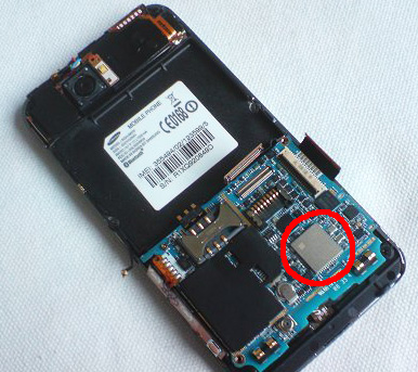

Guest Alien-Tech Posted May 11, 2010 Report Posted May 11, 2010 (edited) Long story short.... My Omnia was placed on the roof of the car and than flew off after first speedy cornering. I was able to find it about an hour later after I started to miss her :P The visible damage was minimal due to hard case protection, which was partly broken when hitting the ground. The main blow was in the lower left corner. I assembled the parts together (back cover, protection and phone) and start it up. The phone started quite good. I noticed several purple spots on the dark background but all the rest seems fine. Phone, GPS and camera works without a problem.... then I noticed it is too warm and battery drained completely after 15 minutes. I fully charged the phone and switch it on..... surprise the battery drains within 40 minutes from 100% to 0%. The phone is hot as hell in the lower level, battery is normal temperature. Any suggestions? UPDATE: Well I disassembled it's chip-set together with all the coolers (tiny metal plates over the processors). I found out that this little piece of s***, circled below on the picture emits enormous amounts of heat. It literally burns. After I assembled it together I think it' better, but wait at least 12 hours and I'll report back. If even anyone cares about this :D NEW UPDATE: I think it's a problem with cooling plate on those chips, high heat goes hand in hand with high battery drain! I send it to service, let's see what they'll say! I hope it's not going to be an economical total. Edited May 14, 2010 by Alien-Tech

Guest Alien-Tech Posted May 11, 2010 Report Posted May 11, 2010 Maybe you could disassemble the whole phone and check everything. maybe the camera is always on maybe the battery connection is touching something... etc... That is my plan... today I'll disassemle it. I can visualize with the PC's, that cooler would probablly be misplaced, but the phone?
Guest Alien-Tech Posted May 14, 2010 Report Posted May 14, 2010 SOLUTION: Due to quite a good hit on the ground, the main processor cracked. That caused the overheating and battery drain. Funny thing is, the device worked with no major problems apart of the ones written in the first post. I was lucky to know a few people so I got it repaired for free. :) My Omnia has a new heart.

Guest sis651 Posted May 30, 2010 Report Posted May 30, 2010 @Alien-Tech Did they change only the CPU, or the motherboard?
Guest Alien-Tech Posted May 30, 2010 Report Posted May 30, 2010 Only that two chips under that metal plate, as shown on the picture. They gave me the old one. It looked pretty burned :( I think Omnias arent build for hard crashes :(
Guest sis651 Posted May 30, 2010 Report Posted May 30, 2010 If there are still stability problems there may be some other broken parts too. Or they couldn't mount the chips well. In fact with its metal case Omnia seems to be fine for crashes but crashes for its case. Metal conducts the bump to the inner parts, but if it were plastic it may have not been so cool but, plastic absorbs the bump. I had used a Toshiba G500, fairly fine plastic but dropped many many times, yet no cracks. :(
