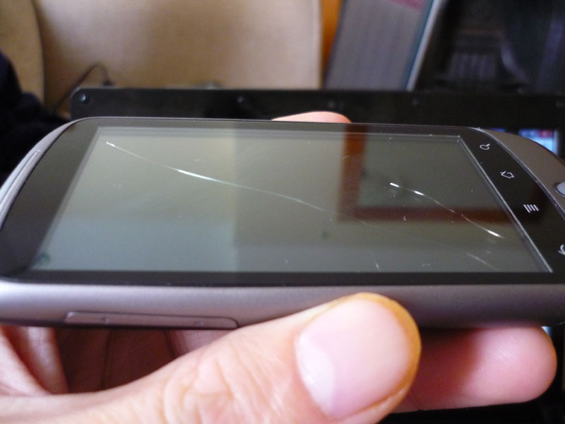

Guest squirreleater Posted May 27, 2010 Report Posted May 27, 2010 Well a seemingly small fall ( 2 foot) resulted in my Nexus screen going all washed out and hardly readable, over the next few hours it got worse and worse so that now I cannot use the phone...... The phone works fine, as does the touch screen! strange, I just answer calls by pressing where I know the answer button should be! The phone was in it's case, but landed right on a corner at a perfect90 degrees to the ground, so I guess the shock went straight through the phone, breaking the screen (the glass is fine, it is below that has gone. Jeese I'm fed up
Guest fuzio1963 Posted May 27, 2010 Report Posted May 27, 2010 Well a seemingly small fall ( 2 foot) resulted in my Nexus screen going all washed out and hardly readable, over the next few hours it got worse and worse so that now I cannot use the phone...... The phone works fine, as does the touch screen! strange, I just answer calls by pressing where I know the answer button should be! The phone was in it's case, but landed right on a corner at a perfect90 degrees to the ground, so I guess the shock went straight through the phone, breaking the screen (the glass is fine, it is below that has gone. Jeese I'm fed up OUCH!!! That hurts!!! :rolleyes:

Guest squirreleater Posted May 28, 2010 Report Posted May 28, 2010 Thanks for the advice. an update for you (I will update this as we go for reference, we may as well learn from my mistake!) HTC picked up the phone this afternoon, I rung them at 9.15 and they arranged it, emailed me within 5 mins with the various info... Apparently the LCD screen replacement is about £60 parts and labour, not bad at all in my opinion, should be 7 days. Turns out the call centre in in bournemouth! I used to live about 3 miles from them, and the Girl I spoke to also had a Nexus! Repair centre is in Milton Keynes. She also wouldn't/ couldn't tell me when the OFFICIAL 2.2 froyo would drop, but she did say "in june" ( The 2.2 out there is just a developers rom, not official)

Guest squirreleater Posted June 6, 2010 Report Posted June 6, 2010 That is impressive ... let us know how it gets on and what the final costs are inc shipping and VAT! Ok, an update. They emailed me Thursday morning with a quote of £78 delivered to repair the screen, I emailed them back as soon as I could to confirm. I then emailed the lady who seemed to be looking after my job and she confirmed they had indeed received my confirmation and payment- closely followed by an automated response. I hoped for an email Friday to confirm delivery etc, but I'm still waiting.....Maybe if I'd replied straight away it would have sped it up?.... So you know, they email you a quote with a link to pay either the repair, return of the phone as it was or tell them to bin it. You Cannot pay over the phone (I tried) you have to pay via online with a credit card. I will post when I get an email confirming delivery and again when it arrives, so you know the overall timescale.

Guest squirreleater Posted June 7, 2010 Report Posted June 7, 2010 I had that same "perfect drop" where mine landed right on its side. About 3.5 feet. Same results. Hairline crack at first. Screen looked like that after 8 hours. After 2 days, it was completely unreadable. So if this happens to you, recover what you can immediately because the screen will get worse. HTC overnighted me (free shipping) a new Nexus and sent a shipping label (also free) to return my injured one. Here in the US, they shipped via FedEx and required a signature in person. (I picked it up at the FedEx facility, since I couldn't take a day off) Despite being unlocked, rooted, and running a yet-unreleased HTC Desire ROM, final charge for a new phone swap was $US 125. Very good advice, I did have time to do various backups but didn't, by the time I twigged it was too late.

Guest squirreleater Posted June 9, 2010 Report Posted June 9, 2010 I've been wondering that? will they un-root my phone and will it come with 2.2? The girl at HTC said it was officially due in "June"...... Well, hopefully I will find out very soon! An email today from HTC saying phone was repaired and would be with me within a couple of days. FYI: they automatically send it back to the address it was picked up from. Mention to Sarah G at HTC who has been superb at responding to my pathetic pleading to get it fixed and back to me asap!
Guest squirreleater Posted June 10, 2010 Report Posted June 10, 2010 Another update, email this morning from HTC , my device will be picked up today and delivered tomorrow by UPS. Hurrah!
Guest squirreleater Posted June 11, 2010 Report Posted June 11, 2010 Final update. Phone arrived this morning via UPS, the day after An email letting me know it was shipping. It has come Re-Locked! It was rooted and running a MCR rom, that has all gone and is back to how it was from google all those months ago- gits! ( No padlock on startup screen) Overall very good service from HTC, certainly try them before any others if you damage your phone.

Guest squirreleater Posted September 5, 2010 Report Posted September 5, 2010 I'm about to return my Nexus One with the same fault and I'm glad to read you had such good customer service. All I want to confirm is whether it's my screen/digitizer that's cracked or the LCD screen beneath it? When I switch the phone nothing appears but I now it's on because it vibrates on boot up as normal. Can anyone confirm for me? Can't really tell from that pic. My glass on the surface was completely ok, the visible damage was underneath. My phone booted and was even working for a bit, but gradually as the lcd died so did the phones ability to respond, eventually I couldn't get anything other than the physical buttons to respond.
Guest Raviff Posted September 8, 2010 Report Posted September 8, 2010 my gf droped hers twice, from the waist down, on the second time the screen cracked in quite a few places, won't even show any image anymore, but the phone is still working... I ordered a new screen from cnn.cn, should arrive tomorrow or so, and I'm gonna have to do the replacement, since we don't have service suport anywhere near here... I'll post some pics of the proccess, hopefully it will work again when I'm done eheh

Guest Raviff Posted September 11, 2010 Report Posted September 11, 2010 I've done it, her phone is alive again, but it was quite troublesome... took me about 2 hours to do the whole thing (second time ever taking a cell phone apart, first time was her siemens, that didn't quite work after lol) the above guide helped me take it apart, as well as the video on cnn.cn, on the digitalizer link, but putting it back together was the hard part, luckly I found these youtube videos that helped quite a bit http://www.youtube.com/user/slickromeo I'll post some pics of the proccess tomorrow or by monday
