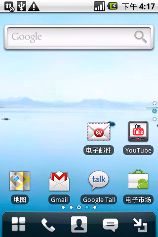

Guest angryland Posted May 28, 2010 Report Posted May 28, 2010 (edited) http://www.huaweidevice.com/worldwide/down...20&treeId=0 http://dl.dropbox.com/u/42132/U8230-2.1.zip http://u.115.com/file/t53f4d20a6 U8230 U8230 V100R001C123B819SP01(Swi tzerland Sunrise) Host Software 2010-05-27 121594KB Sorry for screenshots in Chinese.... Known issues: original boot.img will not enable the touch....(that means touch won't work, so I used the pulse 2.1 instead) hardware buttons seem not correct (power button won't light the screen to unlock... I just unplug and plug the usb to light the screen...also double press of menu won't work) wifi not work; although there is signal for network, however I never successful to dial a number... since when I press the number the dialer software quit... no vib, since I didn't flash the firmware, update by update.zip most problem: sloooooooooooow suggestion: to use the pulse 2.1.... who would like to try this? :rolleyes: within the system.img build.prop writes build.zip And further more, is it possible for you guys to download this through the address below? please try. http://u.115.com/file/t53f4d20a6 and click the middle button of the below three. (First needs specific software, last never try) Further further, i found in the boot_versions.txt and upgradable_versions.txt the december update of T-mobile's code (U8220V100R001C85B118SP01) which means we could just apply this UPDATA.APP? I'm not brave enough to try.... boot_versions.txt upgradable_versions.txt # begin build properties # autogenerated by buildinfo.sh ro.confg.hw_appsbootversion=U8230V100R001C123B819SP01_APPSBOOT ro.confg.hw_appversion=U8230V100R001C123B819SP01_KERNEL ro.confg.hw_appfsversion=U8230V100R001C123B819SP01_SYSIMG ro.build.display.id=U8230V100R001C123B819SP01 ro.build.id=ERE27 ro.build.version.sdk=7 ro.build.version.codename=REL ro.build.version.release=2.1-update1 ro.build.date=Tue May 4 19:44:18 HKT 2010 ro.build.date.utc=1272973458 ro.build.type=user ro.build.user=huawei ro.build.host=huawei-desktop ro.product.cpu.abi=armeabi ro.board.platform=msm7k # begin of volatile config ro.build.version.incremental=20100504 ro.build.tags=ota-rel-keys,release-keys # Do not try to parse ro.build.description or .fingerprint ro.build.description=msm7201a_surf-user 2.1-update1 ERE27 20100504 ota-rel-keys,release-keys ro.build.fingerprint=RBM2/U8230/RBM2/RBM2:2.1-update1/ERE27/20100504:user/ota-rel-keys,release-keys Edited May 28, 2010 by angryland

Guest superl Posted May 28, 2010 Report Posted May 28, 2010 I sure hope they release 2.1 for U8220 soon... The anticipation is killing me! :rolleyes: my phone reboot and i see android 2.1 welcom screen but i have no response of my touchscreen !!
Guest Hectic Posted May 28, 2010 Report Posted May 28, 2010 At my phone it runs to a half because, the upgrade hangs up at 70-90% but its a vanilla 2.1
Guest Hectic Posted May 28, 2010 Report Posted May 28, 2010 my phone reboot and i see android 2.1 welcom screen but i have no response of my touchscreen !! yes, you have to switch that kernel to run this thing
Guest david_dawkins Posted May 28, 2010 Report Posted May 28, 2010 my phone reboot and i see android 2.1 welcom screen but i have no response of my touchscreen !! I wonder if this is because of the firmware update of the APP file. I've extracted the APP, and I'm wondering if I'll be able to rebuild it as a ZIP according to Bear's sticky... where's a bear or an obrien when you need one?
