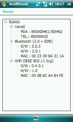

Guest Brkic Posted September 14, 2010 Report Posted September 14, 2010 (edited) hi everybody, I`m new with i900 Omnia and i have problem with WiFi, when I turn ON WiFi with Wireless Manager just write "Unavailable" and after 10-15 min show a message that is found the Internet,I click OK and agen write "Unavailable" and Internet is not locked and router is 5m from the phone. I have checked "Turn on available network notification". once he managed to connect and then the connection is always fired. where is a problem? maybe the problem is ROM ? how much time you need to find a new connection when you turn ON WiFi with Wireless Manager ? this is my version of the ROM and I want to change it to better that will not make a problem, if the problem is Rom. Edited September 15, 2010 by Brkic
Guest Brkic Posted September 15, 2010 Report Posted September 15, 2010 I solved the problem, I replaced the ROM, and now everything works
