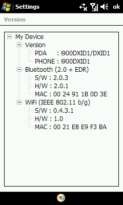

i had ock's premium rom 6.5 flashed on my device .. but i had to go back to the stock rom , so i searched a lot and found this rom , i took a chance and flashed it using windows xp .. while flashing custom roms it usually shows green bars on the device indicating the progress of the process.. like wise while i was flashing on this default 6.1 rom everything went on smoothly but the green bars which show up on the device were stuck on 2 green bars.. but on the computer the process was going on... so i did not panic finally it showed job done.... and in the end the device was successfully flashed to the samsung default 6.1 rom
FOLLOW THE FLASHING PROCESS ACCURATELY AND THERE SHOULD BE NO PROBLEM (TO BE SAFE I TAKE NO GUARANTEE IF ANYTHING GOES WRONG)
i am also attaching this image to show the version of my device now.. the device is working flawless like it was new

By the size this looks like i900_DXID1_SECANY....this is good one...i have it on my omnia...works perfectly...
