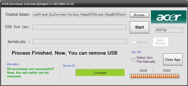

Guest navygino Posted July 21, 2010 Report Posted July 21, 2010 Extracted the .bin but MD5 fail in Acer Download Tool...... any idea???

Guest navygino Posted July 21, 2010 Report Posted July 21, 2010 (edited) the reason is the packed version not worked with CSL rom to this rom directly - extract .bin and flash wtih ACER TOOL 3.1 should be work not yet try extracted the bin but the MD5 fail and I tried to flash anyway but not success. Edited July 21, 2010 by navygino

Guest navygino Posted July 21, 2010 Report Posted July 21, 2010 I somehow flash the bin successfully even the MD5 is fail !!!! OS_Acer_1.100.09.AAP.GEN2_A21E_Liquid.bin Download link here: Do it at your own risk, you had been warned!! http://www.speedyshare.com/files/23464884/...N2_A21E.bin.zip
Guest navygino Posted July 21, 2010 Report Posted July 21, 2010 Flashed again and it is repeatable.....
Guest supergod Posted July 21, 2010 Report Posted July 21, 2010 (edited) Flashed again and it is repeatable..... Wow, you are pretty brave to do so. :angry: I did it in a "safer" way, well at least I think so. (Error message free.) I just flash my Liquid back to the previous release 2.000.13.AAP.GEN2 using the Acer Download Tool 3.1 (The old download tool does not care about the previous rom version) Then I can use the official installation package (Acer Download Tool 5.2) to flash the new 1.100.09.AAP.GEN2 rom. (It checks if the current installed rom is GEN2) Anyway, the stock rom is pretty slooooow and laggy. I used superboot for 1.100.05 to root the unit(works fine). Then I put LCR 1.7.2 on it and it's running fine at the moment. Edited July 21, 2010 by supergod
