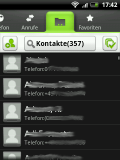

Guest gforums Posted July 21, 2010 Report Posted July 21, 2010 (edited) Pulse Mini MG Custom Rom r3 I renamed the rom as I now used mike's customrom as base, therefore it will be called "MGcustomrom". M for mike. G for gforums. mkay? :-) *** Back from vacations. *** **** This one is working on my pulse mini (UK), but you use it at your own risk **** credits: Paul, flibblesan, mike (m2te), Darktremor, CM, ogiogi, ... Now with working WIFI/3G and USB-SD-Mounting!! Gallery Fixed Working A2SD Instructions (07/26 Updated): * no need to flash original rom on 1st step anymore * 0.) Ensure your battery is fully loaded. 1.) Be sure to have installed a recovery image: http://android.modaco.com/content/t-mobile...on-your-device/ I recommend using AmonRA! 2.) Start recovery mode by pressing "green call button" und "volume up" together while powering on. 3.) Choose "partitioning" and select 0 MB Swap. I recommend 256/512 MB Ext2. 4.) Additionaly do a wipe of data and dalvik cache and power off. 5.) Download the zipped custom rom here: http://daten.gforums.de/r3b-pulsemini-MGcustomrom-signed.zip or here (release r3 if problems occur...) http://daten.gforums.de/r3-pulsemini-MGcustomrom-signed.zip Copy (don't extract!) the zip file to the root of your sd card. 6.) Start recovery mode again by pressing "green call button" und "volume up" together while powering on. Choose "Install zip from sd", select the zip file and press the pad-button to start installation. When finished, go back and select "reboot now" from the menu. (note: first boot takes some time...) (note2: now you can wipe as you like...:-) Good luck! r3b-pulsemini-MGcustomrom-signed -------------------------------- * replaced contacts app: sim card import fixed, browsing trough contacts fixed * removed FLB Custom Scripts (not working) r3-pulsemini-MGcustomrom-signed -------------------------------- * modifications on boot.img for smoother performance (thanks flibblesan) * modified mike's boot.img for A2SD (thanks mike m2te) * added darktremor's latest A2SD * replaced with ogiogi's latest espresso theme 1.2 * icon pack for launcher pro on /sdcard/media * includes original data.img, so the virtual CD and USB-SD mounting works * added estrong file manager (thanks, mike :-) * added root explorer, barcode scanner * added market speedup and headphone fix scripts * updated google maps to 4.3.0, facebook * updated launcher pro to 0.7.1.0 and moved it to /data/app * replaced gallery with 3d gallery, now working r2-pulsemini-MGcustomrom-signed -------------------------------- Features: * signed rom * superuser, busybox * many stock apps: mms, contacts, calendar, music, calculator... * Ogiogi's espresso mod (theme) * touchpal input (nicer themed than pink) and stock input * added voice search, maps, facebook, no-wlan-notification, quickboot * added titanium backup, dev-tools, homescreen selector * massive apn list from CM roms * wifi tether!! * changed market fingerprint should list more apps * custom scripts app * ring delay fix * wlan fixes, removed annoying message * louder-fix * no annoying wlan pop-up * fixed sd card and mounting issues * changed default wallpaper * launcherpro 0.7.0.2 and android stock launcher * added wallpapers * preconfigured fancy widget: Temp. in °C, click time for alarm settings. r1-pulsemini-MGcustomrom-signed -------------------------------- * not released, internal *** renamed to MGcustomrom *** r4b ------------ * undone all "wlan fixes", as they caused trouble * when experiencing umts/wlan problems at first boot, please restart the device to resolve them r4 ------------ * now signed! * ring delay fix * wlan fixes (?) * louder-fix (?) * no annoying wlan pop-up * fixed sd card issues: use Amron Recovery to setup a2sd partitions. Swap=None! * changed default wallpaper * added launcherpro 0.7.0.2 * added wallpapers * removed astro file manager as it expires too often and needs updates. * preconfigured fancy widget: Temp. in °C, click time for alarm settings. (?) = report me, if you experience any improvements. r3 ------------ * Based on FLB Mod for pulse and MCR for pulse mini * replaced contacts, calculator, calendar, mms with stock apps * added terminal * added google voice search * added quick boot * changed music app * changed launcher to LauncherPro 0.6.72 * touchpal fixes * Ogiogi's espresso mod * ... r2 ------------ * Added massive apn list from CM * changed colors from the calendar r1 ------------ * Based on MCR r1 * therefore rooted, su, busybox * with stock launcher * removed touchpal from t-mobile, added touchpal from givi italy rom * added framework from givi italy * changed build.prop for black status bar text * changed boot animation to huawei original Edited August 17, 2010 by gforums
Guest gforums Posted July 21, 2010 Report Posted July 21, 2010 (edited) known issues (r3b MG) Copy SIM card contacts to phone/google doesn't work at all. --> fixed known issues (r3 MG) Copy SIM card contacts to phone/google doesn't work at all. Edited July 27, 2010 by gforums
