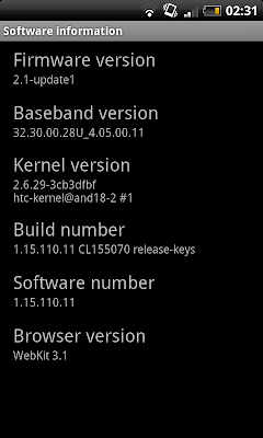

Guest Tid Posted August 31, 2010 Report Posted August 31, 2010 (edited) I'm currently running T-Mobile UK branded Android 2.1 on my Desire, which I rooted earlier today. Eventually I'll probably put one of Paul's Roms on it; but for now I'd just like to go with HTC's stock froyo build (T-Mobile UK are yet to release a froyo update, say it could be another month). I found RUU_Bravo_Froyo_HTC_WWE_2.09.405.8_Radio_32.43.00.32U_5.09.00.20_release_140022 _signed.exe on shipped-roms.com and wondered:Is it compatible with my phone?Where can I get a bit more information on how to apply it to my phone?If it helps, heres the software details: EDIT: Scratch point 2, having read the read me in the RUU it seems pretty straight forward Edited August 31, 2010 by Tid
