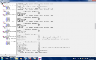

Guest rithchen Posted November 19, 2010 Report Posted November 19, 2010 As all i know is that Win7 will Read usb descriptor to know what device class it is. And chose the proper device driver to install, you can use uvcview to check the usb device descriptor. UVCView.x86.exe
Guest Umka Posted November 20, 2010 Report Posted November 20, 2010 OK, I used teh USWB device viewer you kindly sent and determined which is my device, by pulling it back and pushing it again into the USB port. So here are the interface descriptors I have found - and there is no RNDIS like you have. Maybe this is Modem? But i tried to install the drivers for this one - and it did not work B) : ===>Interface Descriptor<=== bLength: 0x09 bDescriptorType: 0x04 bInterfaceNumber: 0x00 bAlternateSetting: 0x00 bNumEndpoints: 0x02 bInterfaceClass: 0xFF -> Vendor Specific Device bInterfaceSubClass: 0xFF *!*CAUTION: This appears to be an invalid bInterfaceSubClass bInterfaceProtocol: 0xFF *!*WARNING: must be set to PC_PROTOCOL_UNDEFINED 0 for this class iInterface: 0x00 *!*ERROR: 0xFF is the prerelease USB Video Class ID ===>Interface Descriptor<=== bLength: 0x09 bDescriptorType: 0x04 bInterfaceNumber: 0x01 bAlternateSetting: 0x00 bNumEndpoints: 0x02 bInterfaceClass: 0xFF -> Vendor Specific Device bInterfaceSubClass: 0x42 *!*CAUTION: This appears to be an invalid bInterfaceSubClass bInterfaceProtocol: 0x01 *!*WARNING: must be set to PC_PROTOCOL_UNDEFINED 0 for this class iInterface: 0x00 *!*ERROR: 0xFF is the prerelease USB Video Class ID ===>Interface Descriptor<=== bLength: 0x09 bDescriptorType: 0x04 bInterfaceNumber: 0x02 bAlternateSetting: 0x00 bNumEndpoints: 0x03 bInterfaceClass: 0xFF -> Vendor Specific Device bInterfaceSubClass: 0x00 *!*CAUTION: This appears to be an invalid bInterfaceSubClass bInterfaceProtocol: 0x00 iInterface: 0x00 *!*ERROR: 0xFF is the prerelease USB Video Class ID *!*CAUTION: This is an undefined bInterfaceSubClass ===>Interface Descriptor<=== bLength: 0x09 bDescriptorType: 0x04 bInterfaceNumber: 0x03 bAlternateSetting: 0x00 bNumEndpoints: 0x03 bInterfaceClass: 0xFF -> Vendor Specific Device bInterfaceSubClass: 0x00 *!*CAUTION: This appears to be an invalid bInterfaceSubClass bInterfaceProtocol: 0x00 iInterface: 0x00 *!*ERROR: 0xFF is the prerelease USB Video Class ID *!*CAUTION: This is an undefined bInterfaceSubClass ===>Interface Descriptor<=== bLength: 0x09 bDescriptorType: 0x04 bInterfaceNumber: 0x04 bAlternateSetting: 0x00 bNumEndpoints: 0x02 bInterfaceClass: 0x08 -> This is a Mass Storage USB Device Interface Class bInterfaceSubClass: 0x06 bInterfaceProtocol: 0x50 iInterface: 0x00 ===>Interface Descriptor<=== bLength: 0x09 bDescriptorType: 0x04 bInterfaceNumber: 0x05 bAlternateSetting: 0x00 bNumEndpoints: 0x01 bInterfaceClass: 0x02 -> This is Communications (CDC Control) USB Device Interface Class bInterfaceSubClass: 0x06 bInterfaceProtocol: 0x00 iInterface: 0x05 English (United States) "CDC Ethernet Control Model (ECM)" -> This is a Communications (CDC Control) USB Device Interface Class ===>Interface Descriptor<=== bLength: 0x09 bDescriptorType: 0x04 bInterfaceNumber: 0x06 bAlternateSetting: 0x00 bNumEndpoints: 0x00 bInterfaceClass: 0x0A -> This is a CDC Data USB Device Interface Class bInterfaceSubClass: 0x00 bInterfaceProtocol: 0x00 CAUTION: This may be an invalid bInterfaceProtocol iInterface: 0x00 ===>Interface Descriptor<=== bLength: 0x09 bDescriptorType: 0x04 bInterfaceNumber: 0x06 bAlternateSetting: 0x01 bNumEndpoints: 0x02 bInterfaceClass: 0x0A -> This is a CDC Data USB Device Interface Class bInterfaceSubClass: 0x00 bInterfaceProtocol: 0x00 CAUTION: This may be an invalid bInterfaceProtocol iInterface: 0x06 English (United States) "CDC Ethernet Data"
