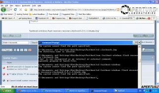

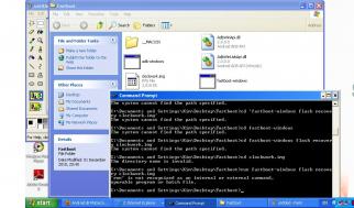

Guest Monty HD Posted December 1, 2010 Report Share Posted December 1, 2010 Hi, Can someone maybe tell me as to why this isn't installing fastboot onto my SF? Screenshot attached. I have the cmd prmt at the right folder on my desktop, but when I enter CD fastboot-windows etc, I keep getting the same error and it is really getting annoying, now! I'm at my wit's end so if anyone can help, I will be forever grateful. Thanks! Link to comment Share on other sites More sharing options...
Guest bugmenot Posted December 1, 2010 Report Share Posted December 1, 2010 Hi, Can someone maybe tell me as to why this isn't installing fastboot onto my SF? Screenshot attached. I have the cmd prmt at the right folder on my desktop, but when I enter CD fastboot-windows etc, I keep getting the same error and it is really getting annoying, now! I'm at my wit's end so if anyone can help, I will be forever grateful. Thanks! 'fastboot-windows flash recovery recovery-clockwork-2.5.1.3-blade.img' Link to comment Share on other sites More sharing options...
Guest Monty HD Posted December 1, 2010 Report Share Posted December 1, 2010 'fastboot-windows flash recovery recovery-clockwork-2.5.1.3-blade.img' Still not working, see attached. Thanks though Link to comment Share on other sites More sharing options...
Guest Vercingetorix125 Posted December 1, 2010 Report Share Posted December 1, 2010 Don't put in CD. CD is used to change directory. Link to comment Share on other sites More sharing options...
Guest Monty HD Posted December 1, 2010 Report Share Posted December 1, 2010 Don't put in CD. CD is used to change directory. Cheers man, unfortunately it now just states 'error: cannot load recovery-clockwork-2.5.1.3-blade.img' Link to comment Share on other sites More sharing options...
Guest Arr Too Posted December 1, 2010 Report Share Posted December 1, 2010 Type "dir" and post another screenshot. Link to comment Share on other sites More sharing options...
Guest Monty HD Posted December 1, 2010 Report Share Posted December 1, 2010 Type "dir" and post another screenshot. Have now figured it out and it is now stating (in command prompt) 'waiting for device' but has been like that for about half an hour. Is that normal? Link to comment Share on other sites More sharing options...
