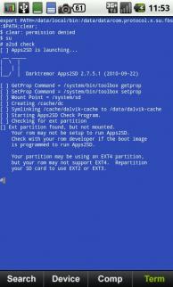

Guest SamH Posted November 10, 2010 Report Posted November 10, 2010 Check if the second partition is mounted anywhere while the phone is running. As I suspected.... I couldn't let this go unsolved! Using a terminal app have run "a2sd check" and produced the following results (see attachment) The SD card has been formatted correctly (several times!) and I've tried alternative cards too. Taking a screen shot is a hit & miss affair. Phone IS rooted but both screenshot apps I've been trying work intermittently. Could this "super user" issue be causing the problem? How do I mount the Ext2 partition? Regards Sam

Guest buneech Posted November 10, 2010 Report Posted November 10, 2010 (edited) On my galaxy spica the sd card is mounted at /system/sd. You can check if you have a folder named sd in your system partition, and if it is infact empty. And from SamH's screenshot I see, that the mount point is the same. You can mount it with the following command (you have to do this just once): mount /dev/block/mmcblk0p2 /system/sd Also, you can see the desired effect if you just write mount in the terminal emulator. Edited November 10, 2010 by buneech
